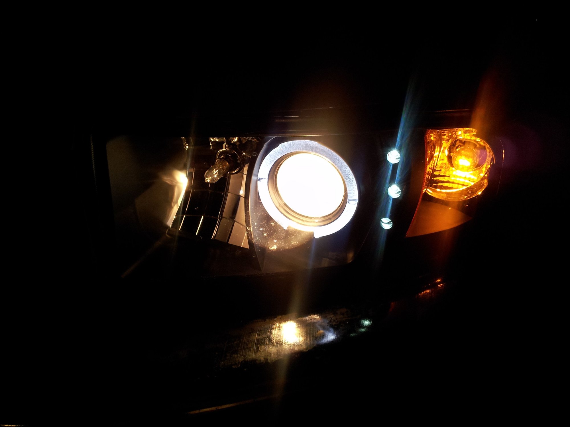

Hey yal gotta headlight question for ya... just got these put in today and they are very dim for low beams so I use thw "highs" to drive but they are just about as bright as the lows SHOULD be... everything is working, should i put a bigger fuse in it to give them more power?
This is the lows both halogen bulb and halos are on

The "highs" turn off the halogen bulb and the halos get brighter but even the highs are about
the same as the lows on my old lights?

I'm looking at your pics and that is not right. The first pic Low beam should only have the outer 9007 projector lit. You are wired wrong and feeding power to the inner 9004 high beam when it should be off!
The second pic you posted 'High beams' should only have the inner 9004 bulb lit and cut power to the outer 9007 projector (unless using the jumper)
These Chinese manufacturers always seems to think the 9004 and 9007 sockets are the same wiring when they are not. You will need to switch the pins on the bulb socket that is wired incorrectly.

@beeker -- that is an awesome catch!
