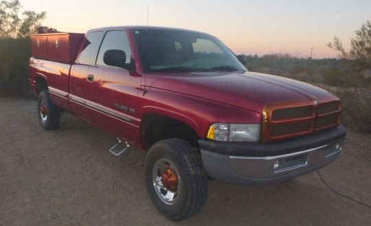

OP here. Thanks for the insights. My '99 2500 runs smooth on 87 and my studies last couple days basically confirm no benefit to speak of. I changed the 02 sensors even though no check engine light and the plugs but still 9-10mpg on digital read out. (4.10 diff) Interesting that when people use higher octane no mention is made about maybe changing plugs to a hotter heat range. Would this make some sense? I read that the QC9MC4 is 3 ranges cooler than RC12...?
