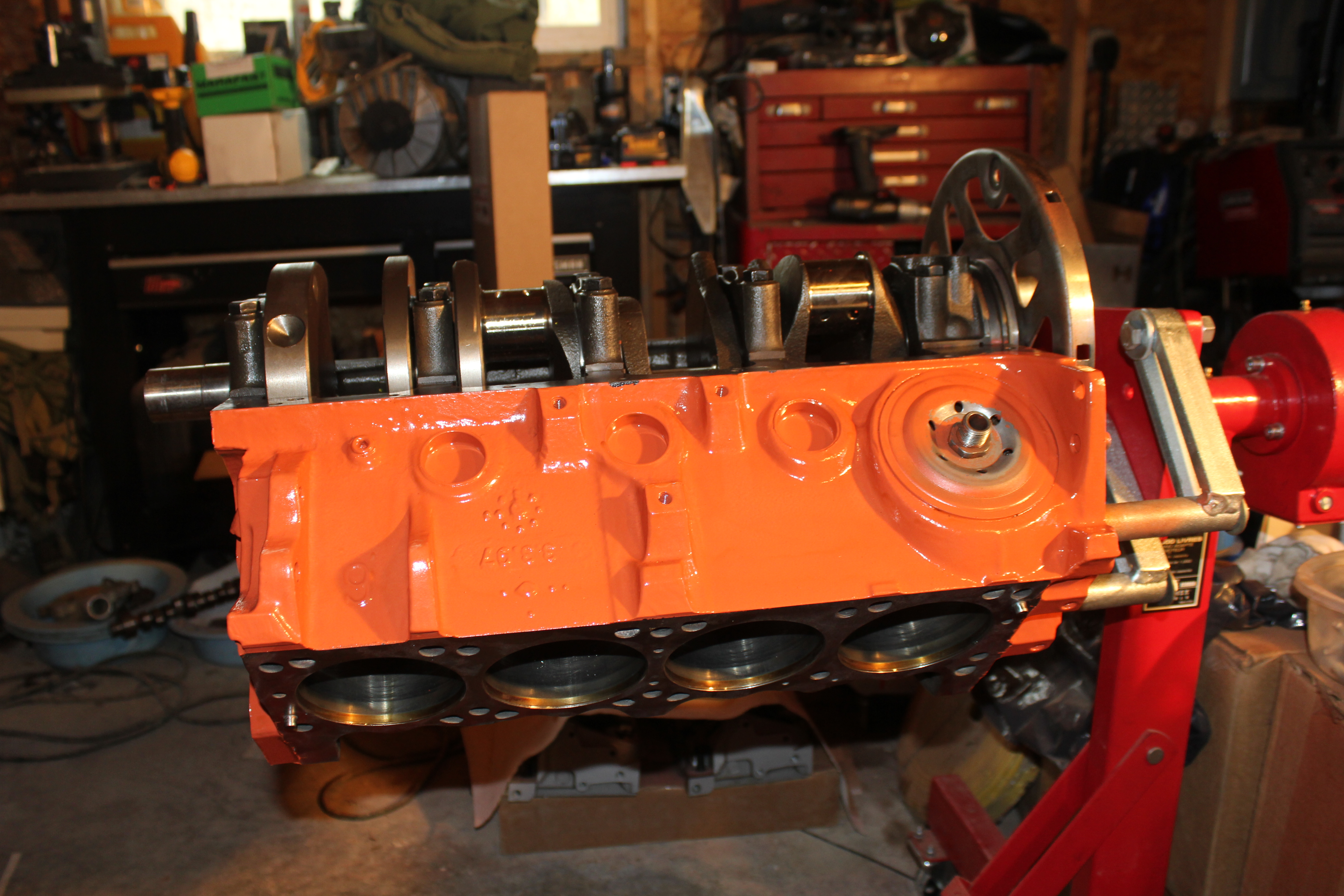

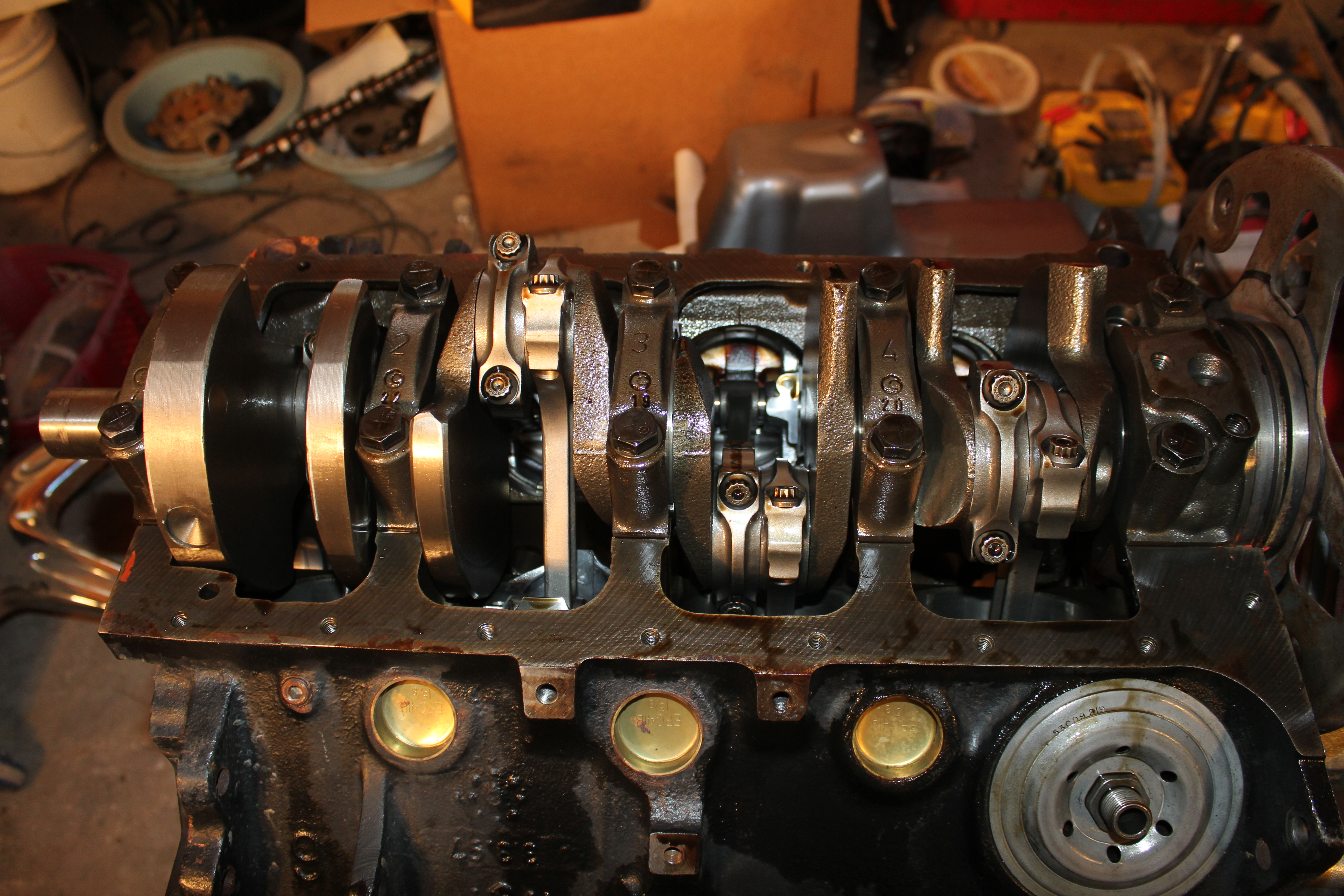

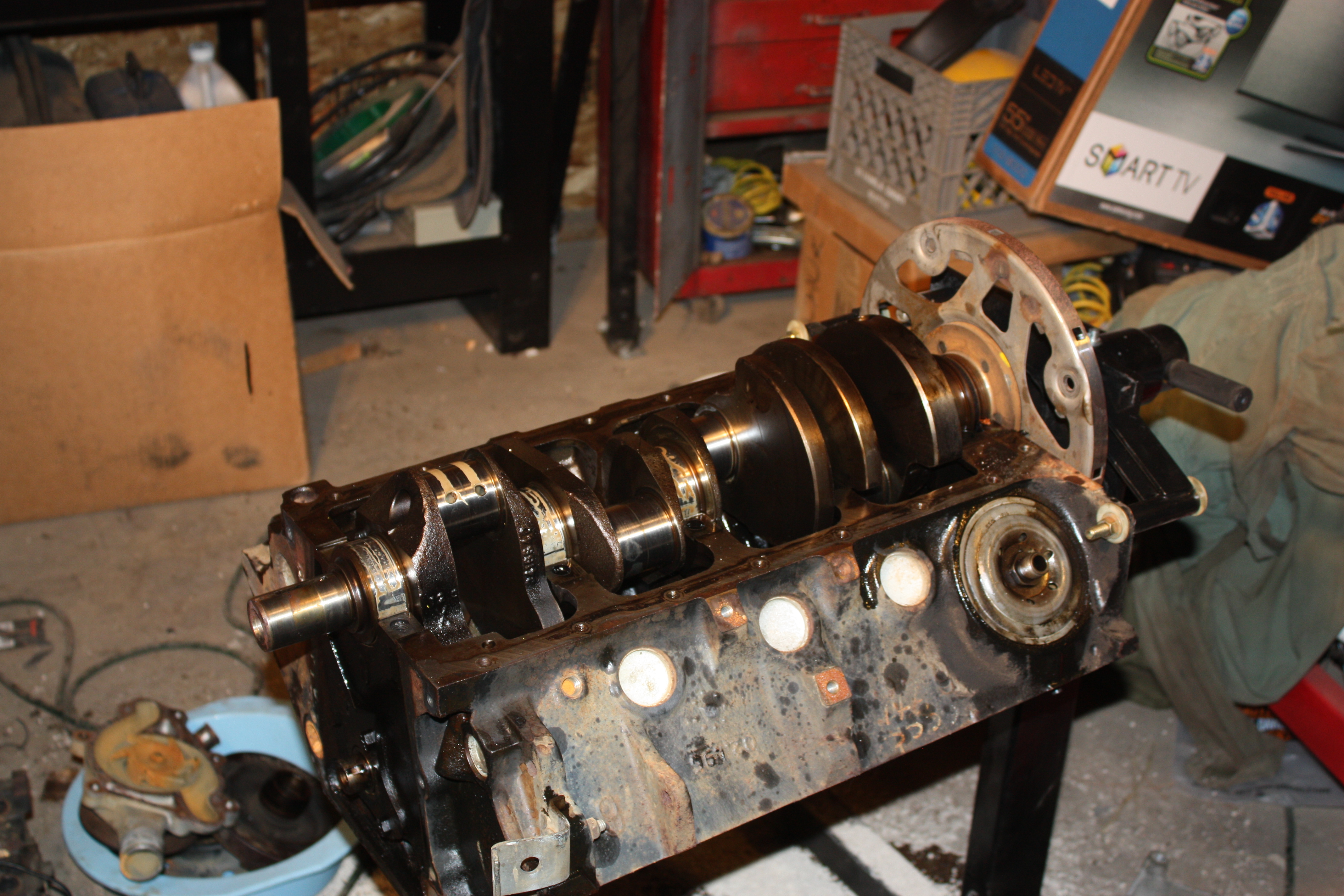

Here is the area around the oil filter. The cover there is held on with a threaded pipe type fitting.
