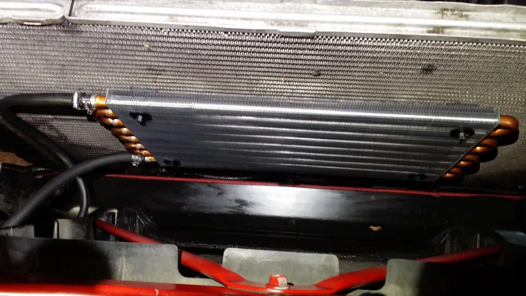

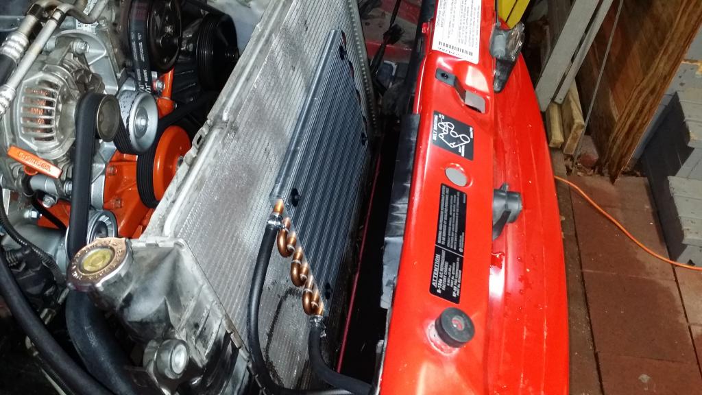

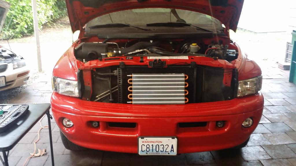

My original trans cooler has been leaking so I bought this new Flexalite Extra Heavy Duty cooler and installed it this weekend.
Got it from JC Whitney on Ebay for only $37 shipped. It came with 4 foot of hose, 4 hose clamps, and the plastic fasteners to attach to the radiator.
It's model# 4126
It was an easy install. Using an external (Long's) trans thermostat with it to keep the temp at 180*.

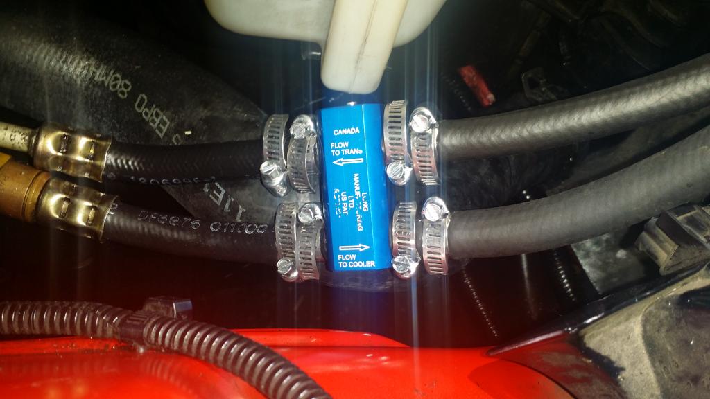

I want to delete my check valve and add an inline filter that has the check valve in it.
Does anyone know where I can get the fittings to convert the threaded lines to the barbed push-on type?
And recommend an inline filter to use?
Thanks

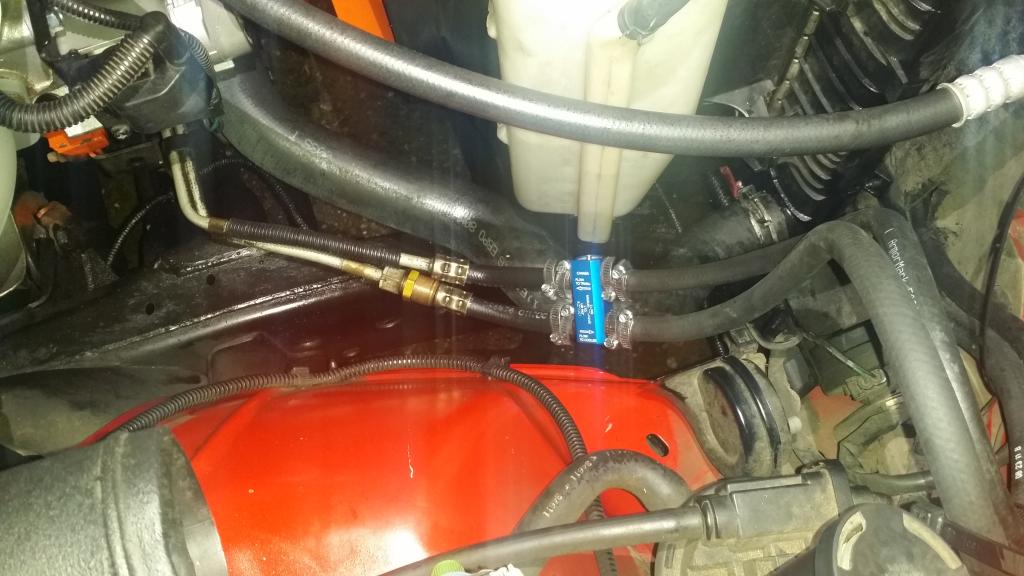

Does the the OE check valve line flow to or from the cooler? I have it flowing to cooler(which I think is how it was) but all the remote filter instructions say to install in the return line.
What line does the remote filter install to?
The flow through the check valve is from the transmission to the cooling system, in the pressure (hot) side.
The line the factory check valve comes out of, the pressure/hot side. That way the crud coming out of the transmission never reaches the cooling system to plug it up.

I like it beeker!
At first I was like...that's in front of the radiator...and then it's the condenser.
So It does fit b/t them just right?
So I have it installed correctly then, that's good!

First pic was just to show the size, it's actually about the same size as the factory air cooler but the tubes are larger diameter. Plenty of room between the radiator and condenser, enough to pancake 3 coolers together(not that you'd want to).

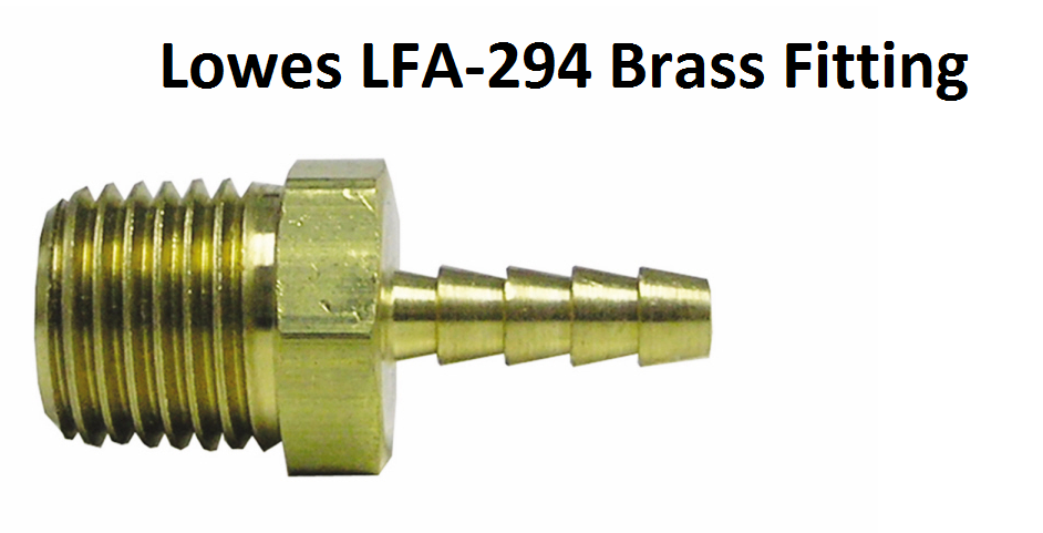

I went to Lowes and picked up the LFA-294 brass fitting to delete my check valve. It's 3/8ths hose barb x 3/8ths male thead. Should thread right into the hot oil line where the check valve currently is.
