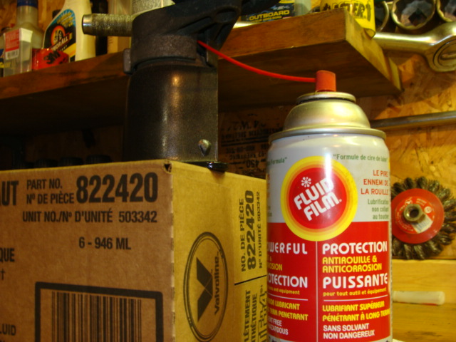

My money is on the tensioner also .
You can fix it right on the truck . Remove belt , apply a penetrating oil like PbBlaster first if seized as in pic . I usually just use Fluid film for a one shot deal . Once applied , simply work it back and forth to full range for about 30-60 seconds . It should be springing back nicely now . Wipe it up , reinstall belt .
