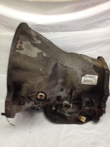

You should have said something sooner. I've had most of a spare transmission sitting in my shop for the past year. No overdrive housing, but I have the main case.
THIS IS NOT MY TRANSMISSION, just an example of the part of the transmission to make sure we're talking about the same bit.
So. Need anything else? How much is this going to cost to ship? Do I need to build a pallet or crate?

So, this is the part that i need, you can se the cracks in the bottom. Sorry if i were confusing you. I Think the right name is transmissioncase

Hm, the Picture was a bit small, i'll see i can try to upload a bigger Picture
Click on either the link or the Picture, and then u will see a bigger Picture.
http://www.ladda-upp.se/bilder/hyeooaauuiddiu/

Yes please confirm where the "cracks" are located and where exactly they are. Pics would be great! From what i understand it may be the overrunning clutch that cracked the housing.

Yes, is the picture alright? Do you see the cracks?

Here are some more pics on the cracks.

Yeah, that's trashed. As is the bearing.

Yes. but there was actually a company here in Sweden that was going to fix it. He had repaired alot of these, apparently it is very common on these gearboxes that this happends. He ordered a repairkit from the US and was about to fix it but for some reason the material on my case was poor so he could not reapir it. He was confused himself since he, as said, had repaired very many of these
Just my luck, but now hopefully horatio102 has one for me!!
