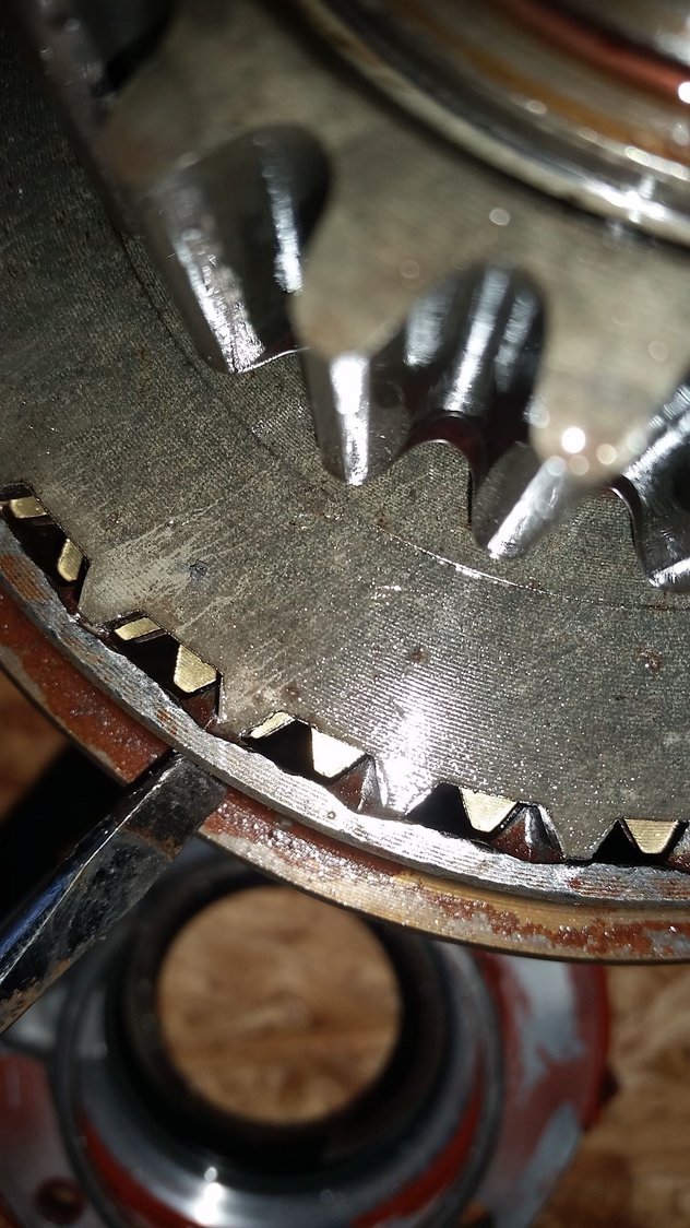

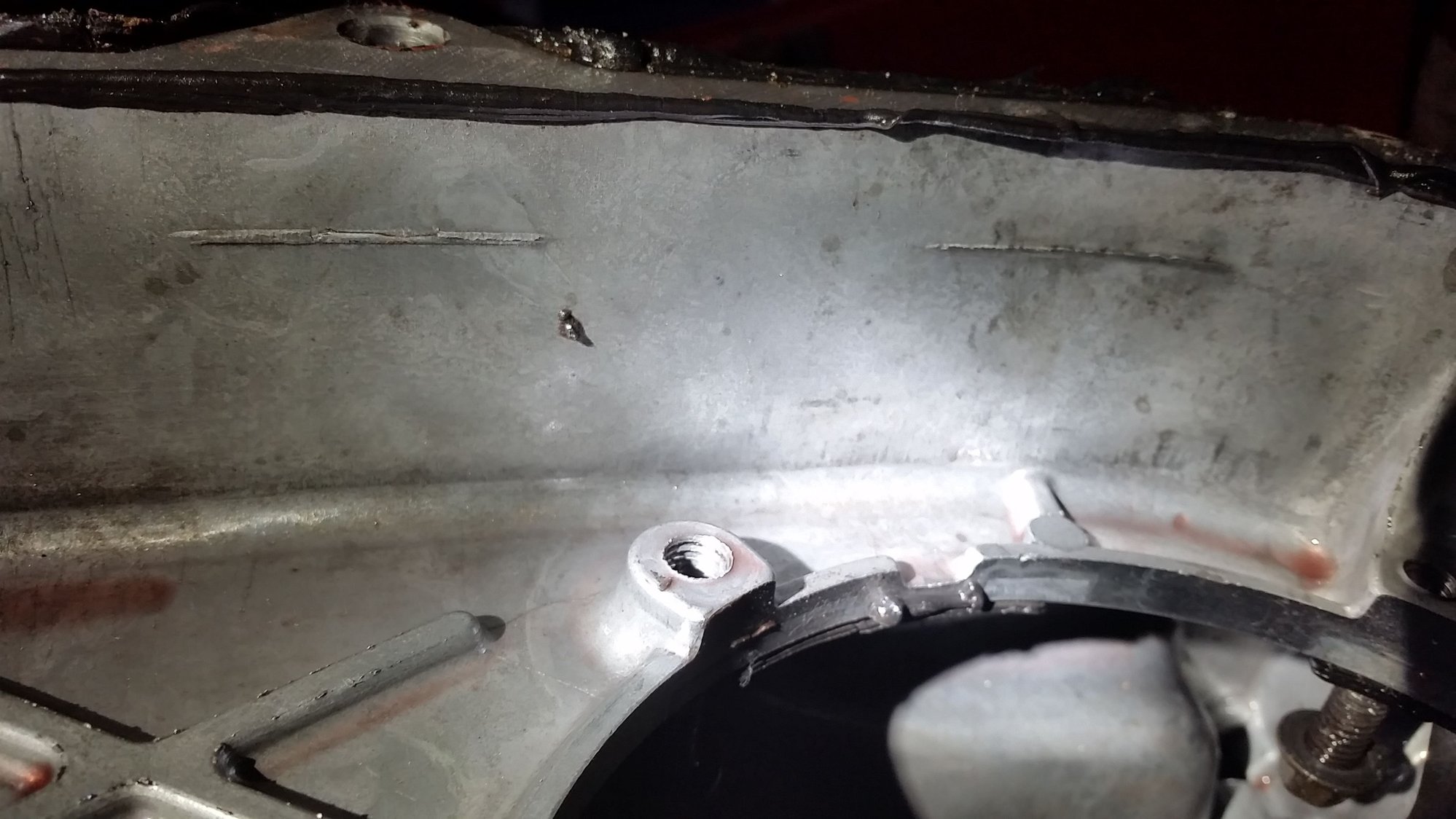

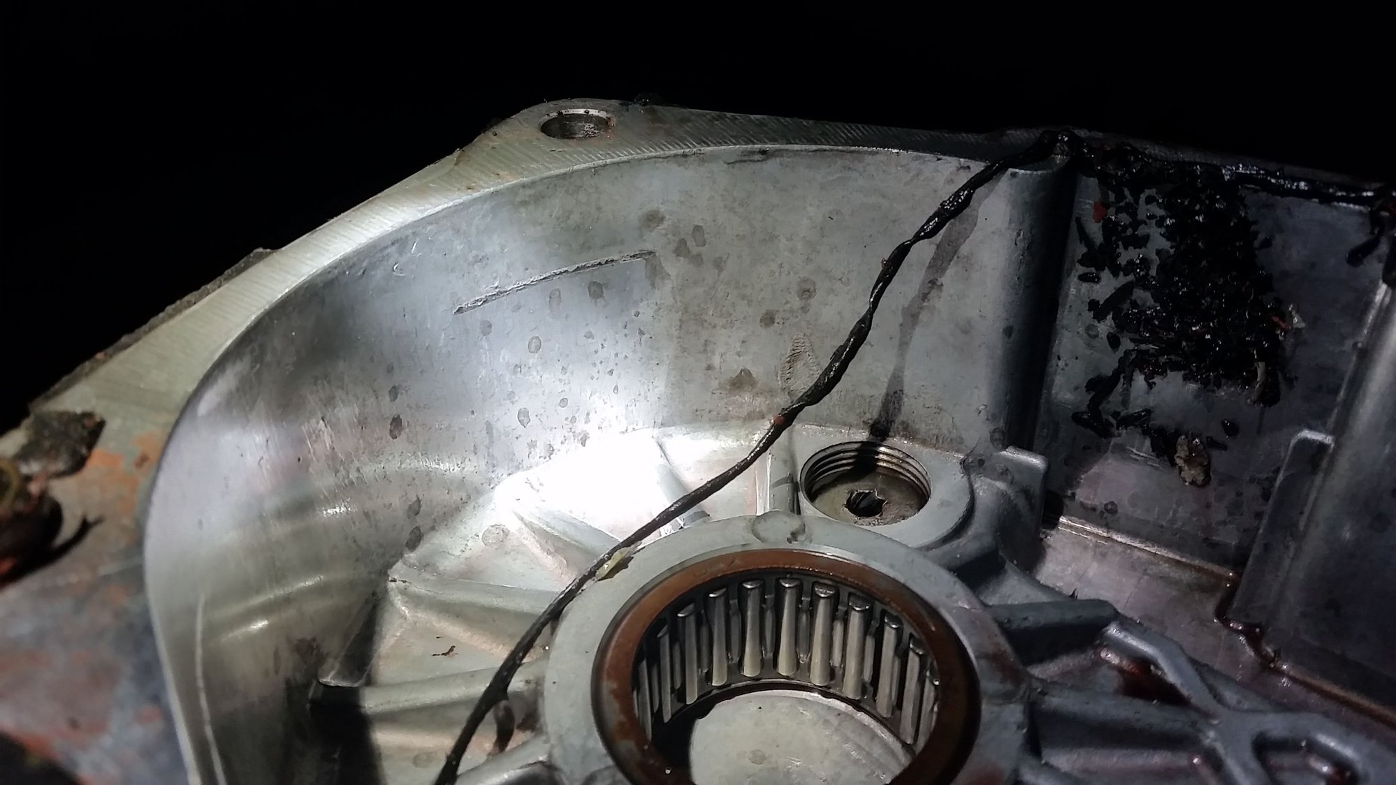

Ok guys I had sometime this weekend to work on my truck. I took my front drive shaft out and went on a test ride and I no longer had the noise that I talked about in the first post . Took the transfer case out and split the case and there was some shavings and lime 2 small like smaller the your pinky nail of metal on the magnet. So I checked all of the gears and this is the only issue I found with the gears. The got looking at the case and found these scratches but they seam to be raised if that makes any sense. My question is do I need to replace the one gear in the photo and if the marks are from the chain or what.

Those lines are just from the casting process. Nothing to worry about.
Do all your bearings and such look good? Shift fork? and the rest of that bit? How much slop in the chain?
I think you can get complete rebuild kits for 150 or so, replacement chain is extra.....
