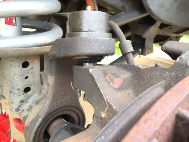

I've just put upper and lower ball joints on ok now the upper the tapered shaft moves in and out this a moog part the problem solver has anybody used this part that can tell me more about this don't seem right to have the space at the top side bottom was a dead match top was maybe factory not sure but I can say the right front is sitting better now was leaning in at the top or out at the bottom lol it was wore out thanks for the help

I have the part and mine has a space too. It had me worried too.

K3134T I ordered them from moog your truck been ok with the space on the top bottom was a great fit had to jack up on the bottom of the bearing housing to hold the ball joint tilling could get it good and tight one thing I saw is the bottom grease zerk I need to get a elbow zerk looks real close to the axle joint what did u do with that
Are you saying it's not locking in? pics?

It's tight there's just a gap its the right one

Yeah, that's how mine is too.

No worries as long as it tightened up and there's no play. That just looks like the boot should have been bigger is all.

Ok then I feel better bout it I knew all the gen 2 guys would help and y'all didnt disappoint thanks one more side to do have a good week c-ya

I think they redesigned the boots. When i put mine on the boot came down and made a seal around the knuckle.
