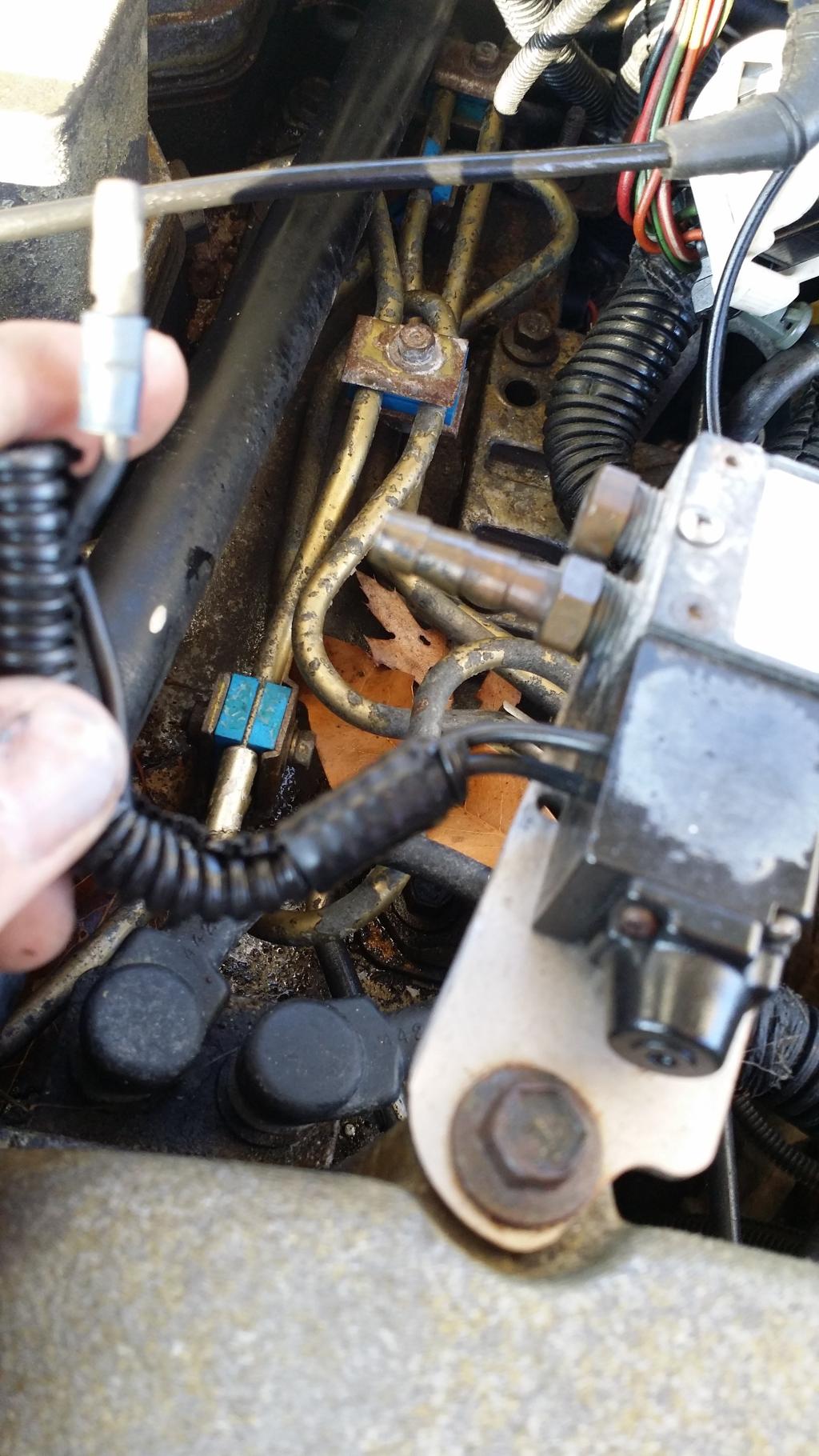

So is this just an issue of low fuel, air getting in the system? I do have a small fuel leak I'm trying to track down btw.Well any ideas if I'm on the right track or no? I was also wondering if maybe I have a positive air shutdown valve...see attached picture have no idea what the thing is.
I have a 12valve and if I run out of diesel or switch my fuel filter. I have to add diesel directly to where the fuel filter is. Might want to check to make sure the fuel filter has diesel in it or else it won't start. I try and not let my truck get below an 1/8th of a tank so I can avoid the headache.
