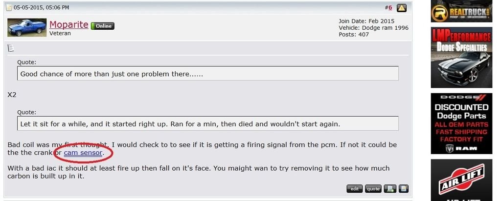

Does it block the blue highlighted words in the posts also? Have to look into it! Better yet, Get rid of the ads! I usually hit stop before they have time to load.

Blue highlight words??? What you talkin' about Willis?
If you are referring to the "Like", and "Share", nope, those are still there.

See pic, Blue words(ad links).

That's weird. I don't see that...... is it a link to a description or something?

It's adware embedded on the page, I just downloaded ad blocker plus for IE and it works.
