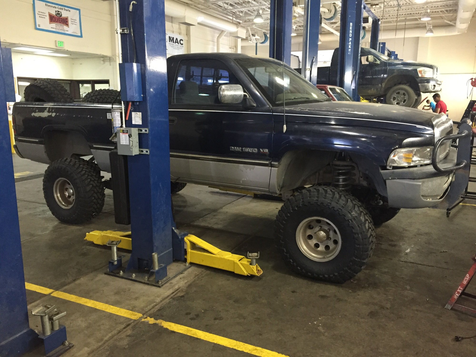

Here is my truck with 35x13.5r15 on 15x10 rims
