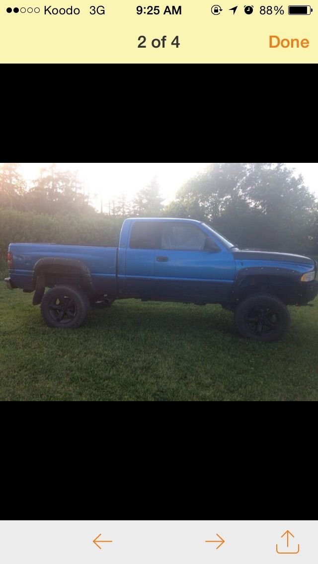

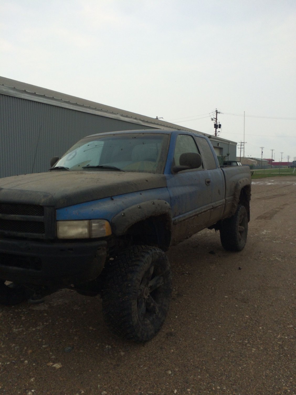

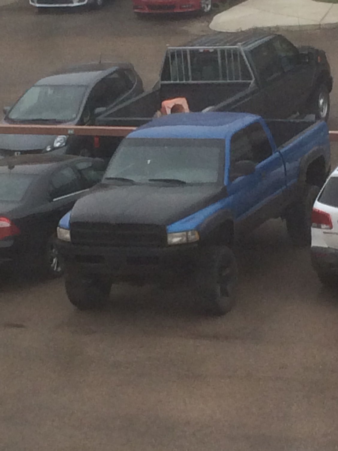

Yeah, hosting on an external site is still recommended.
Good lookin' truck though.

hahaha, yes I see that the quality suffers a lot.
