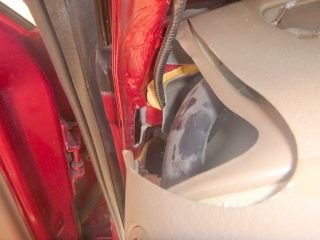

I took these pics of the operation of the TSB:
Left side- Notice 2 in. vertical gap after using chisel to widen to 1/4 in.
Right side- Yes, my dash top is cracked-fixed with Goop. A rug was over it when I bought the truck. I said" that's neat" without looking under it.
No store had a long chisel so I bought a 1/4x1x36in. flat from hardware store and filed down one side with a multi rasp using the coarsest side. I didn't need to cut it shorter but 2 ft. would work well. I used a 5lb sledge to get it in 6 in. Worked better than any other chisel could have. The idea is to widen the gap between the plenum bar and sheet metal wall.
