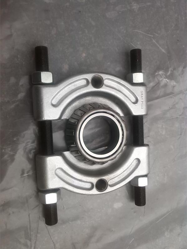

The 3" spreader you have linked is far too small for this so don't waste your time with it. You need this or an equivalent:
http://www.harborfreight.com/large-b...ator-3979.html
I bought a Gray Tools P503 when I did my install
The HF one should be more than adequate to do the job and I would have bought it if I lived in the states, $30 is a steal. Splitter won't work for the carrier bearings, you will need to cut off.

That sucks the larger one doesn't come in that kit, if I bought that single large splitter would that work without all that other jazz? How would I go about using the old bearing to set up the shims? Would sand paper be enough shave a little off the inner race?

"That other jazz" is the puller. You can fab a puller, use a 2/3 jaw, a press or a few blocks of wood to hold the splitter and pound out the pinion gear. Use a brake hone to make setup bearings.

Would I be able to put that separator on top of the bearing and use a press to press it on? I would be skeptical of putting the press on the pinion gear, I saw somebody do it on a Chevy site though

Find a piece of pipe with an appropriate ID and OD to press on the inner race of the bearing
