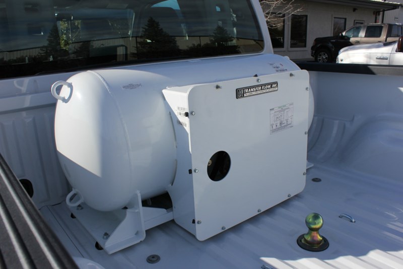

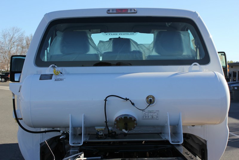

I am rebuilding the engine anyway, so I may build it to take advantage of propane's properties. Lots of compression, advance and the right cam specs make a huge difference. Tanks are not a problem...just generic DOT approved stuff.
Attached Thumbnails Propane Conversions?-propane-20tank-202.jpg   Propane Conversions?-propane-20tank-204.jpg

I suppose I could see it for the novelty value...... my question becomes, how much are you going to have to invest in the fuel system/engine controls, and will it EVER pay itself off with any savings on fuel costs...... Keep in mind, gasoline also does odd and strange things like condition valve seats, and such. (additive packages) Propane isn't going to do that.
In any event, should be an interesting project. What compression ratio you thinkin'? Cam choice?
