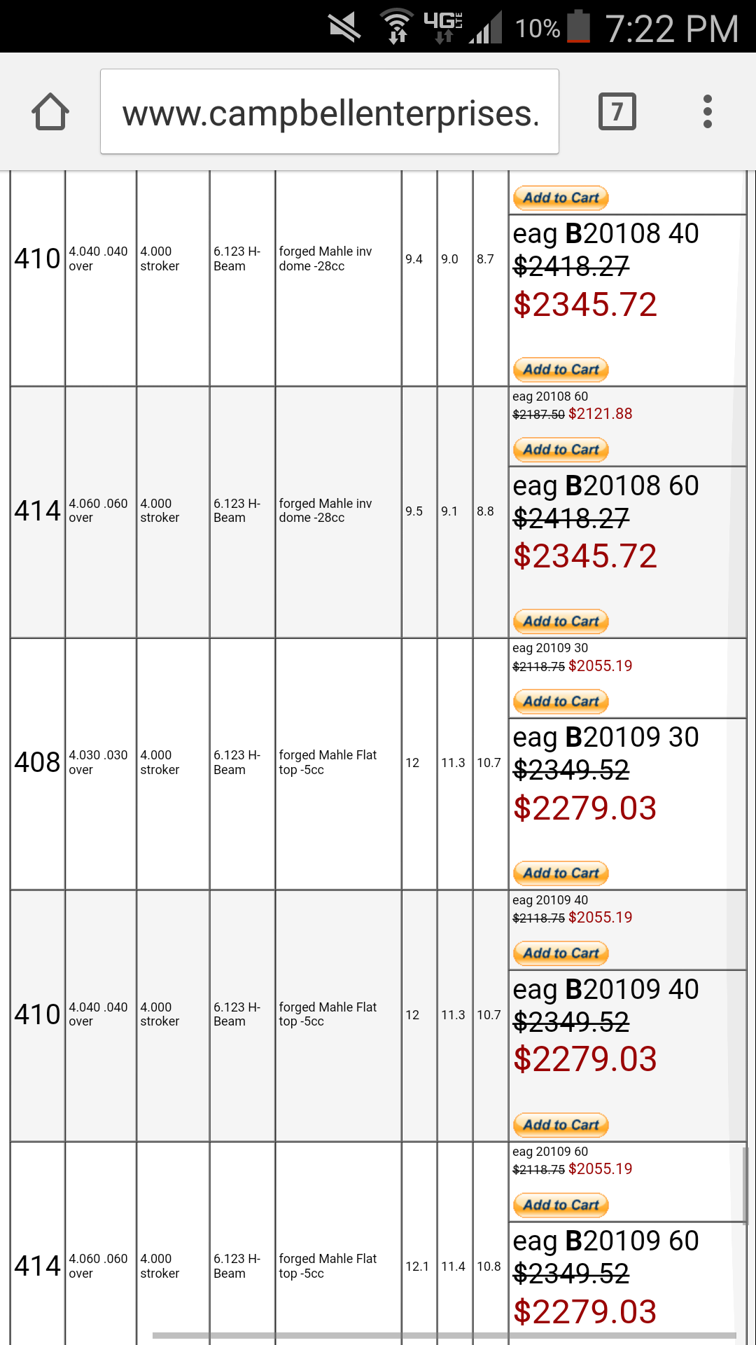

This is where i found the 414 stroker.

Why do you want to go .060 on your bore? You are correct that your 46RH doesn't have all the electronics that a 46RE has. As to being stand alone I can't comment on.
