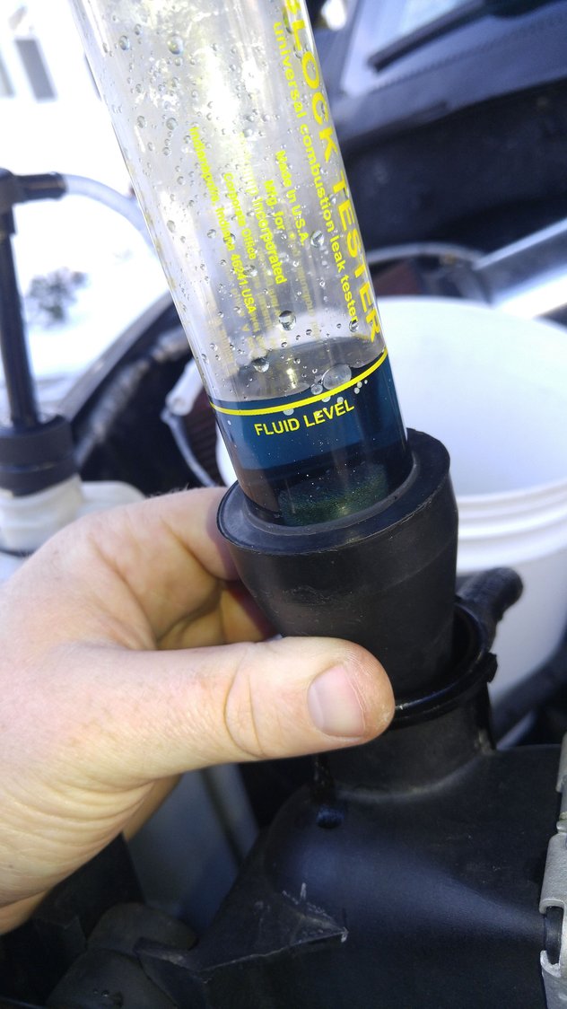

I also ran a chemical block test, I'm sure many of you know the solution is blue and is supposed to turn yellow if gases are present in the coolant system.. My test results showed the solution was still blue after almost 10 minutes of testing, but that it had slightly faded in color. Could the steam off the coolant be enough to slightly change the color?
Before the test
After the test

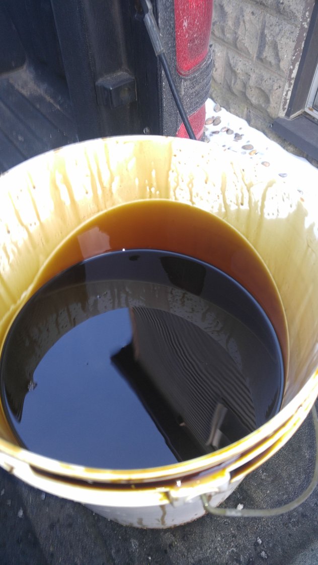

My oil, right before I preformed my fist oil change on my new engine, today.

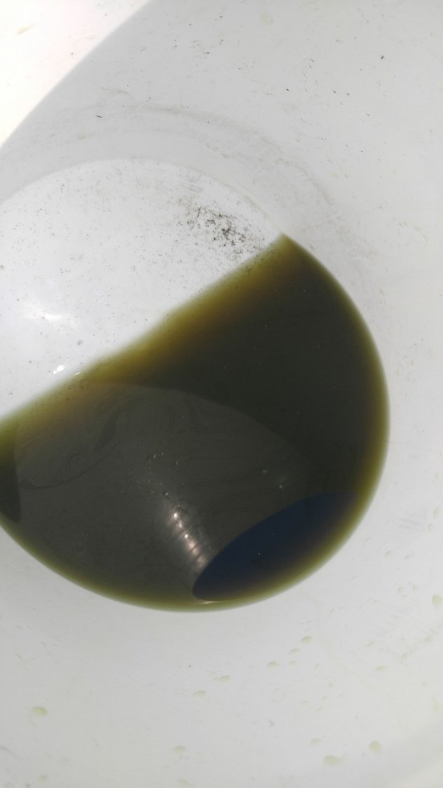

A sample of some coolant from my radiator

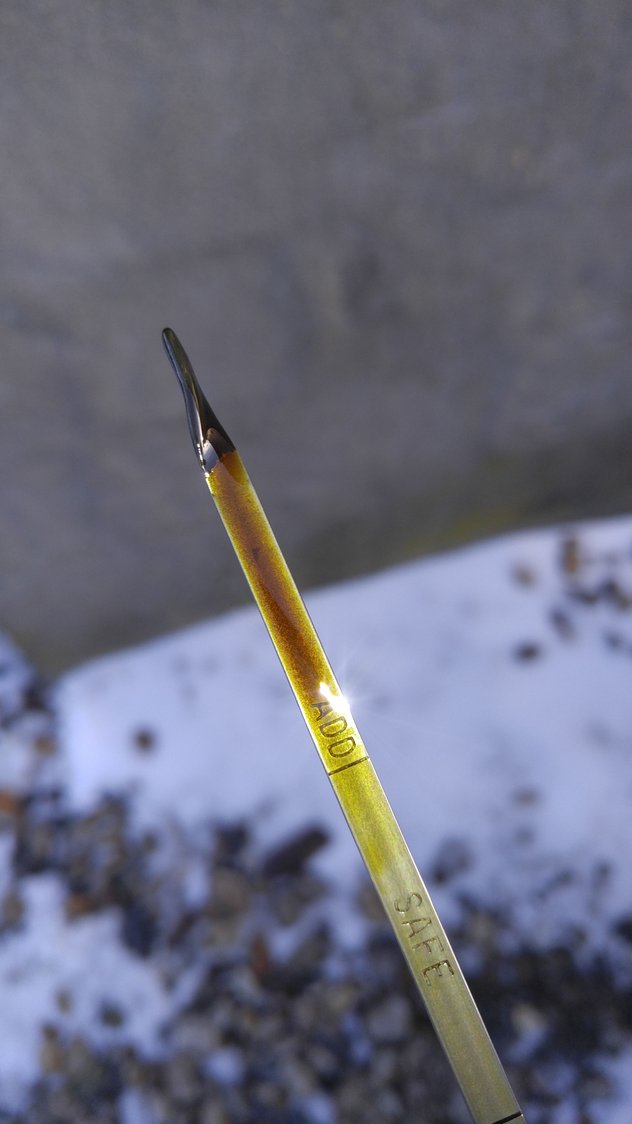

Oil from my engines first oil change, got a little over 4 quarts back after 4k miles

Is it normal for the hydrocarbon solution to slightly change color but still show a negative result? If you can tell from the picture the solution did slightly change, but it still looks plenty blue to me.
