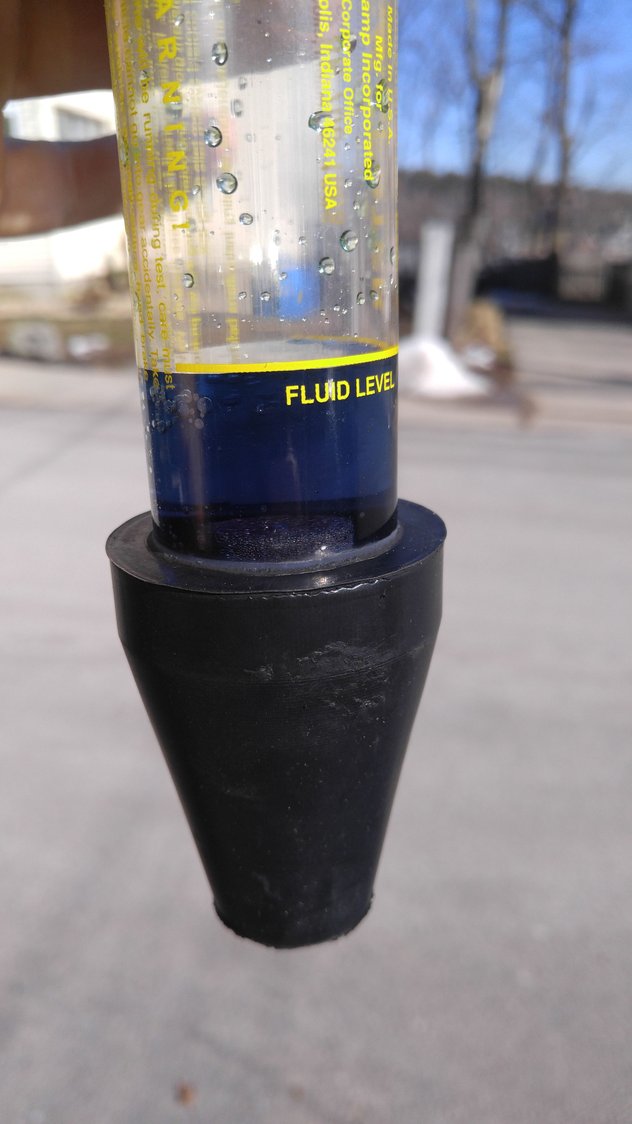

Run the block test again, but this time reach over to the throttle body and raise the rpms while doing so.

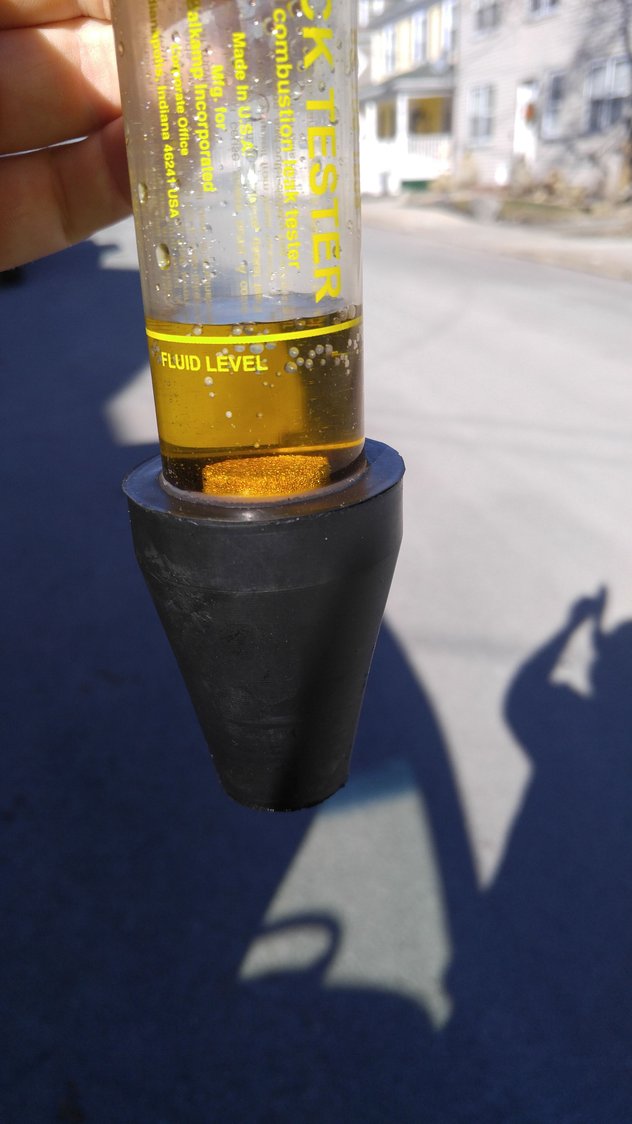

Just ran the test again, and the results are the same! I may be in luck here.. And that's not something I get to say very often, they made up that luck of the Irish thing ya know.
The solution after running the block test for a second time.
This is the solution after I sucked in some exhaust fumes from the tail pipe. Wanted to make sure the solution was good.
