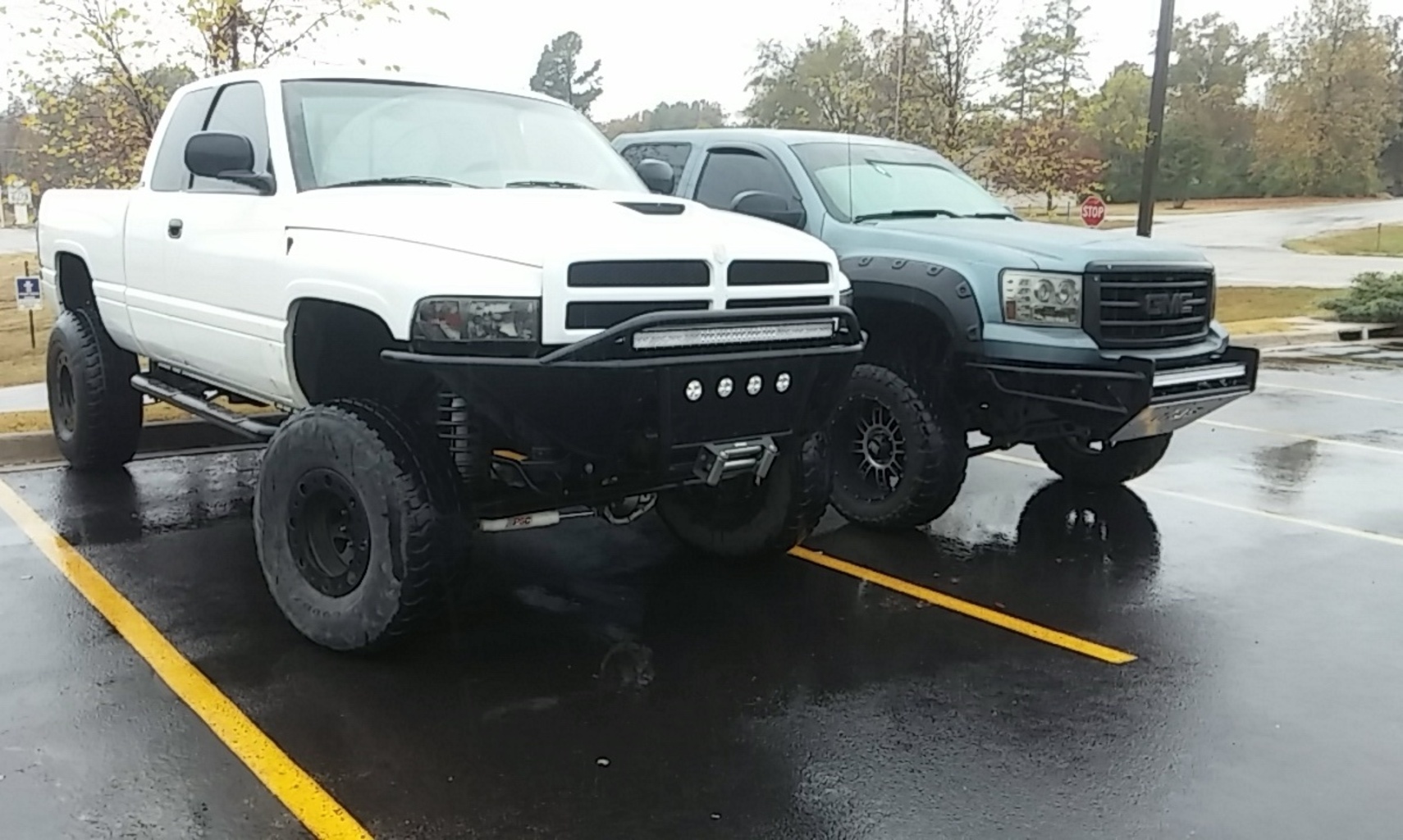

It's pretty clean and a real solid truck.
