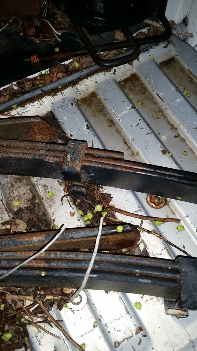

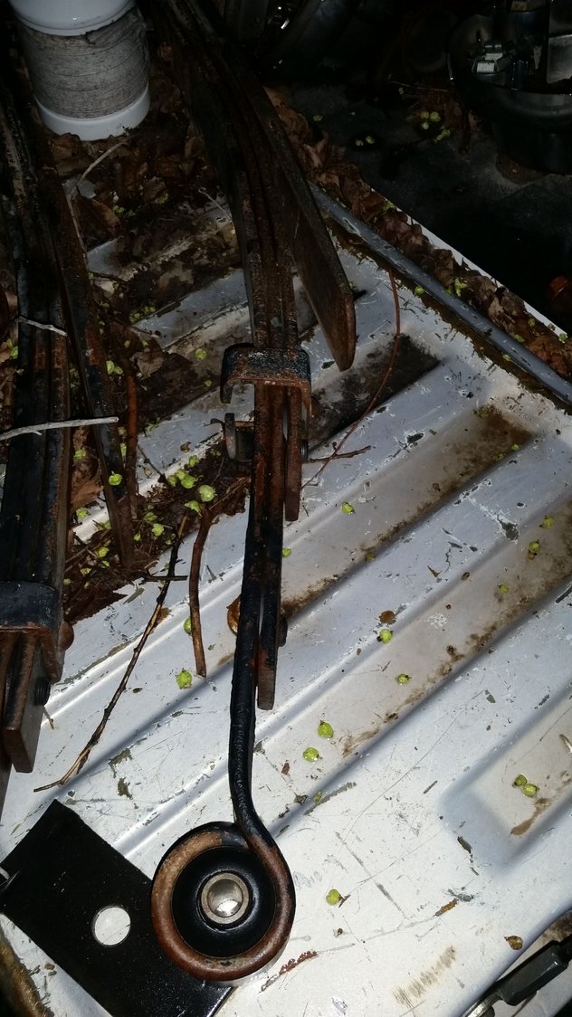

I think the back is stock, at least compared to my 97 1500 springs. Looks like it just has a leveling kit up front.

Originally Posted by Ramman18
The rear pack definitely has a shorty AAL pictured at the bottom of the main three leaves. These trucks shipped with either 3 or 4 leaves but never a shorty. Also, it rusts worse than factory leaves (my Skyjacker long AAL does the same). Also, more than a level puck up front. That is a lifting block of at least 3 in. They were all the rage but I went with new springs to avoid the big plastic donut look.
These are pictures of the stock leafs from my 97 1500. I have two 97 1500s, one for parts and one that was running. Both had identical springs. This is also why I say the back looks stock, but I might be missing something in the OPs picture.

Your packs look like mine did before my AAL. In the OP's fourth picture you can see the very rusty orange shorty AAL in his pack. It is also much thinner than any of the stock leaves. That's his added leaf. Also the crazy long u-bolts gave it away as well.
You are correct. I don't know if the pictures were updated or I'm just that blind (probably the latter) but I couldn't see the AAL at all before.

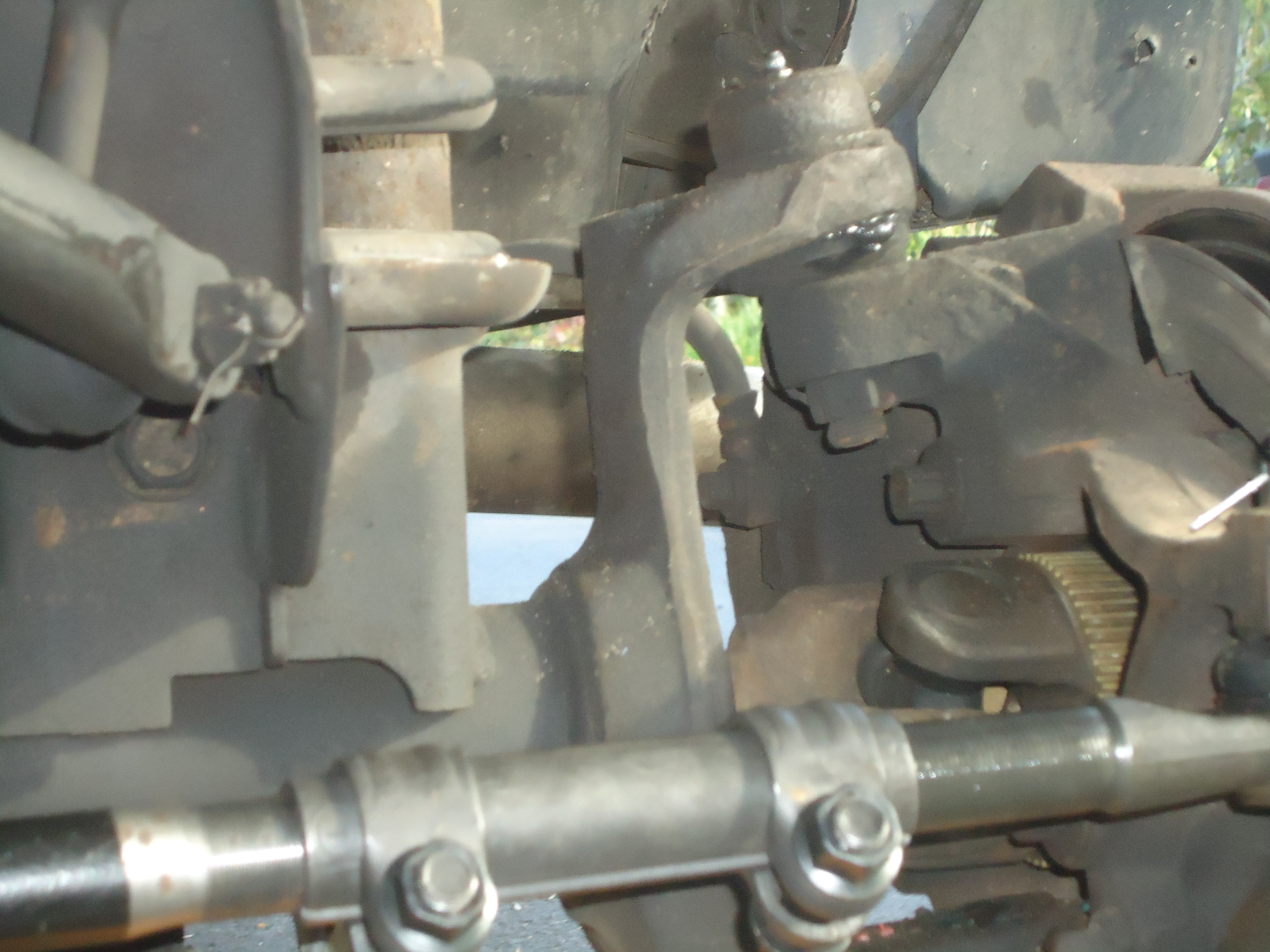

i went ahead and replaced both right and left inner and outter tie rods,track bar,and steering damper. all new even the sleeves for the tie rods. i did it my self and its my first time and i realized my first mistake was not centering my steering wheel . i gotta say other than the front axle being off center to the right a bit and it being way out of alignment it drives much better than it did before. it doesnt drift like a drunk anymore. however seems like front sits a little lower than before and i feels like it kinda bounces a bit if im at a light and let off the brake and hit the brake kinda hard. oh the tires still sit funny.
here is couple pics of under when i had everything apart.

The axle is off because of the lift. Get a 3" bracket from Skyjacker or the like to bring it back. Much cheaper than the alternative.
Ride height shouldn't change unless you adjusted control arms but I don't think you have those either.
What brand tie rods did you go with? Did you consider doing the 98 HD setup?
Oh, and good job! Now do a 0 toe alignment and you should be good. Google "diy jeep alignment" and there's plenty of good sites. Same concept for our front ends.
