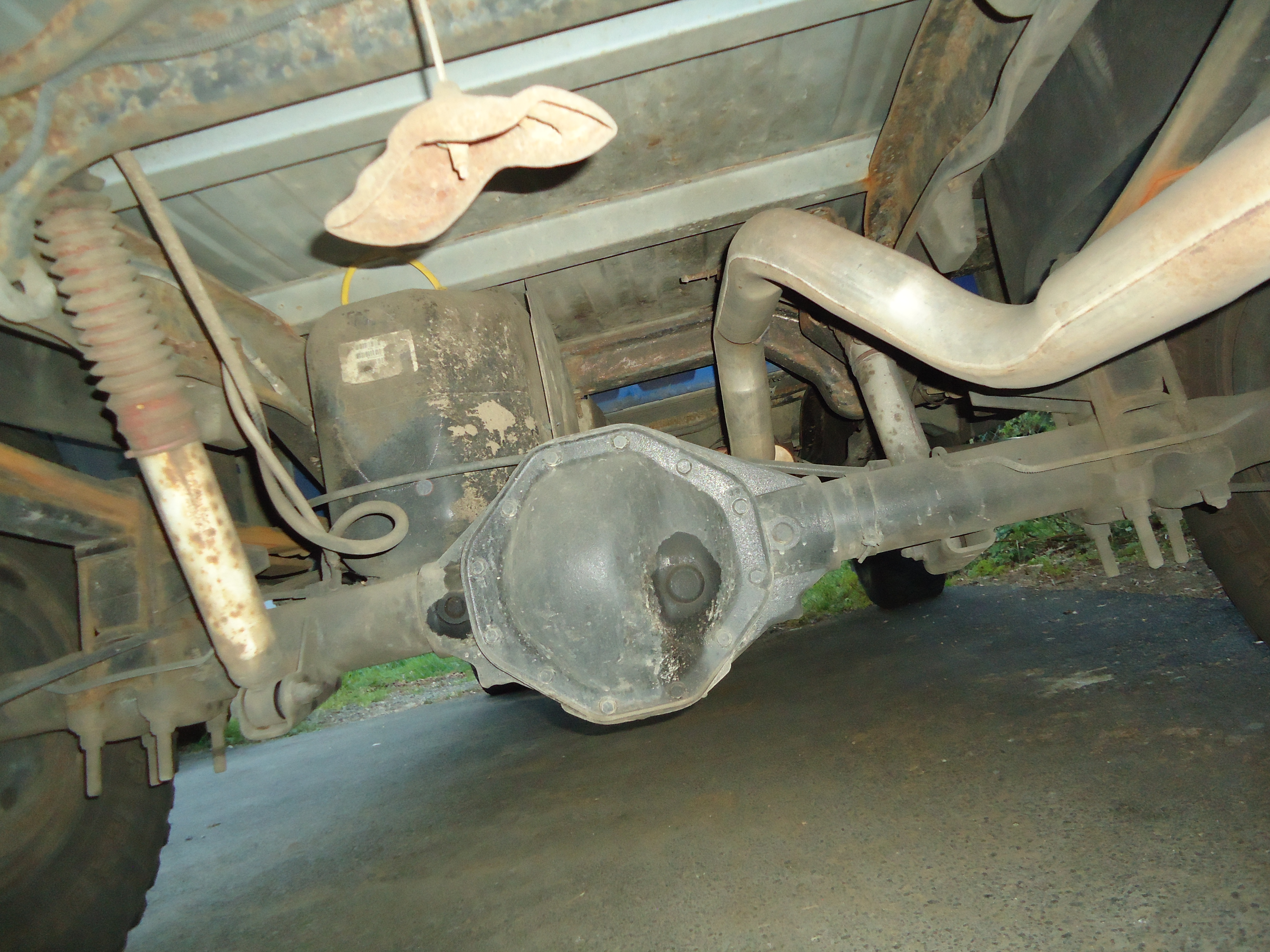

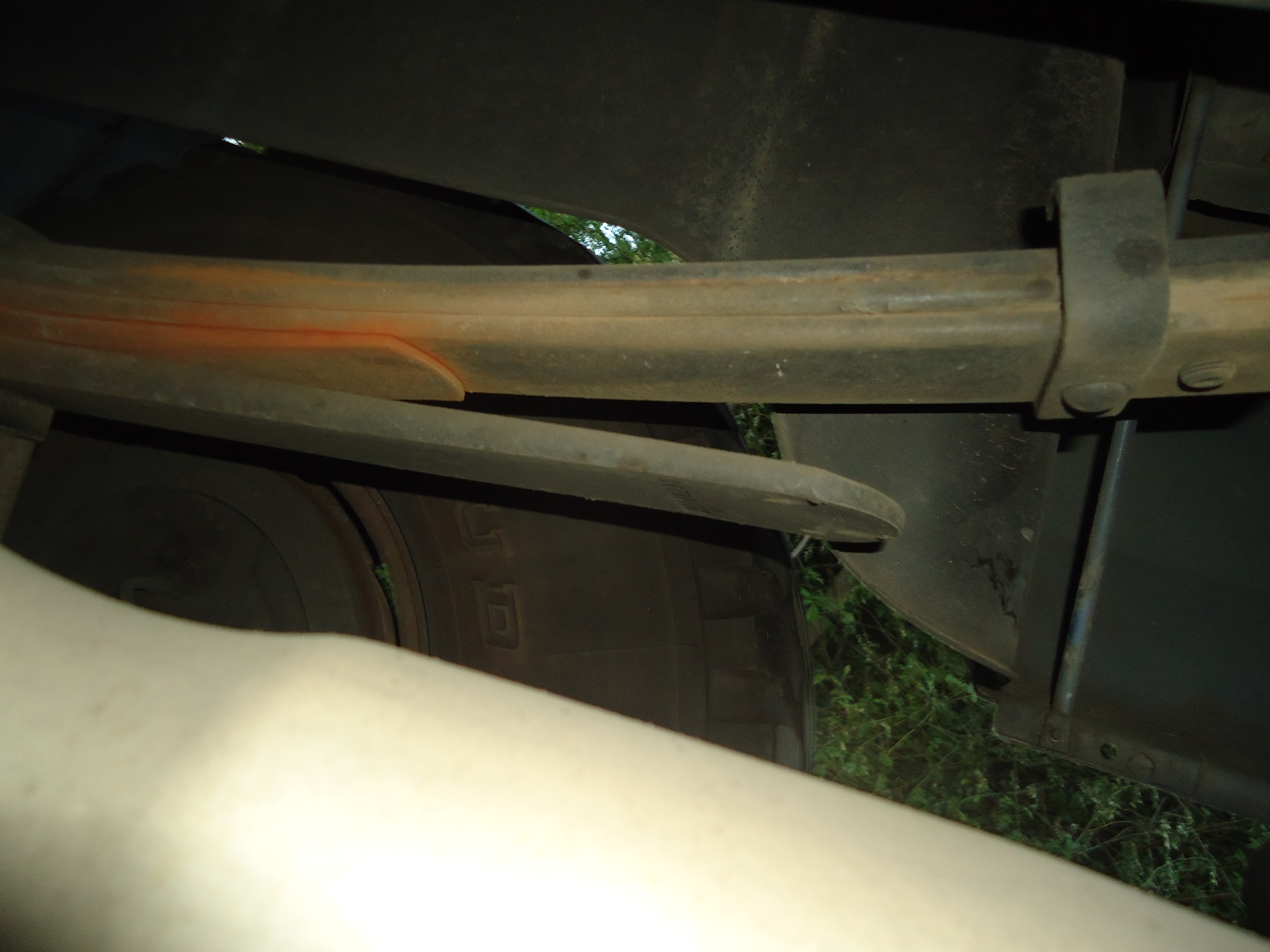

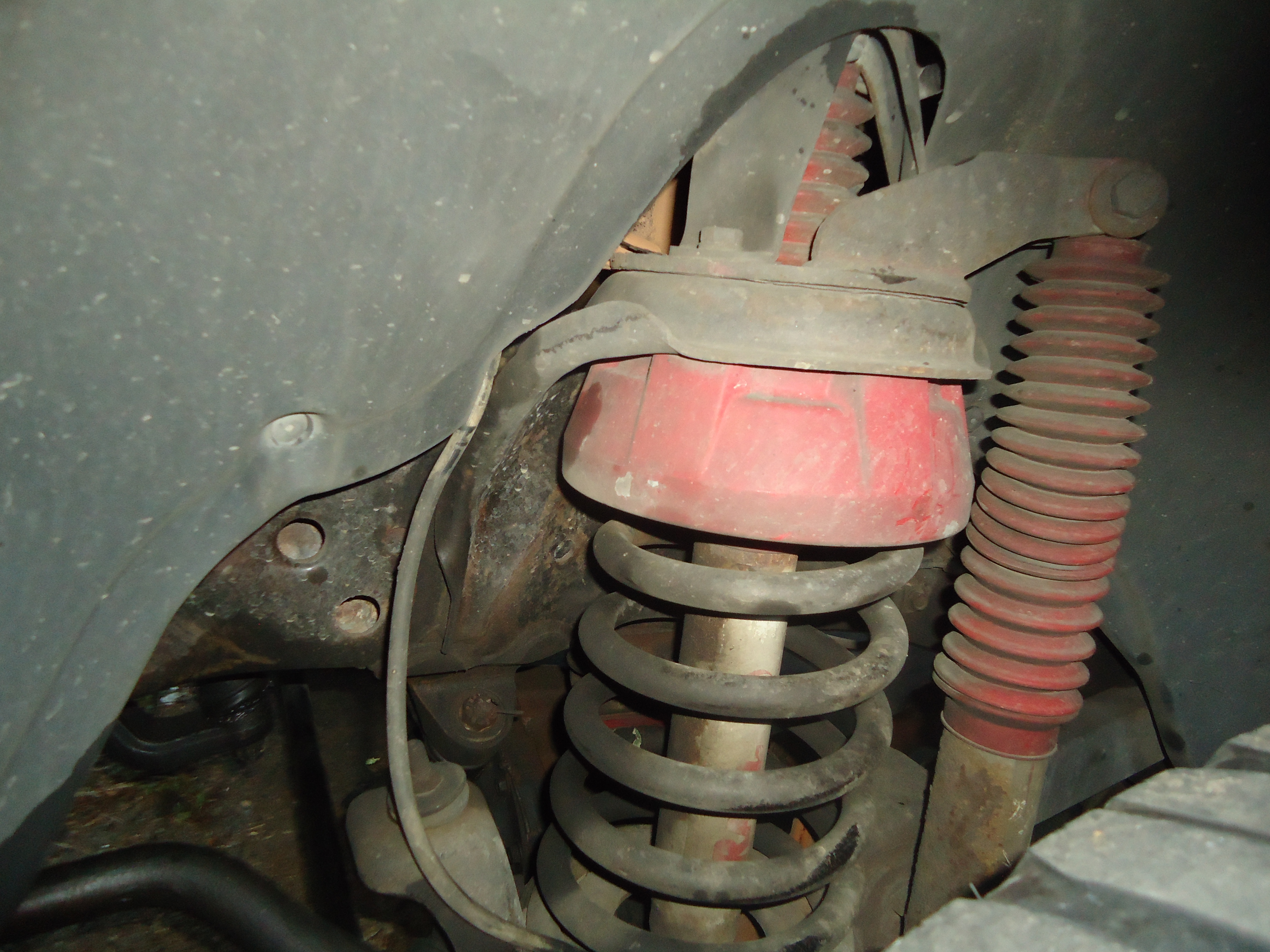

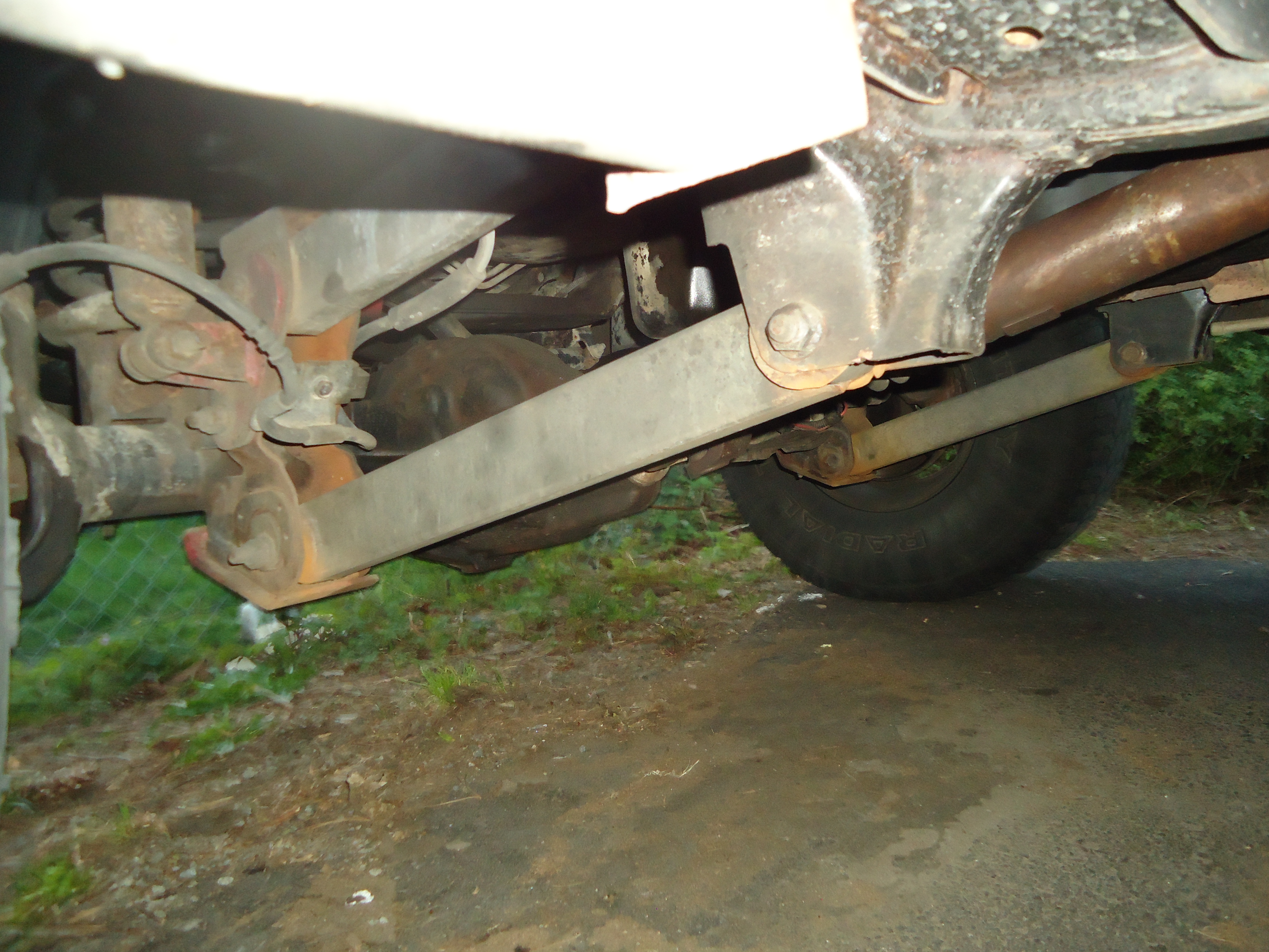

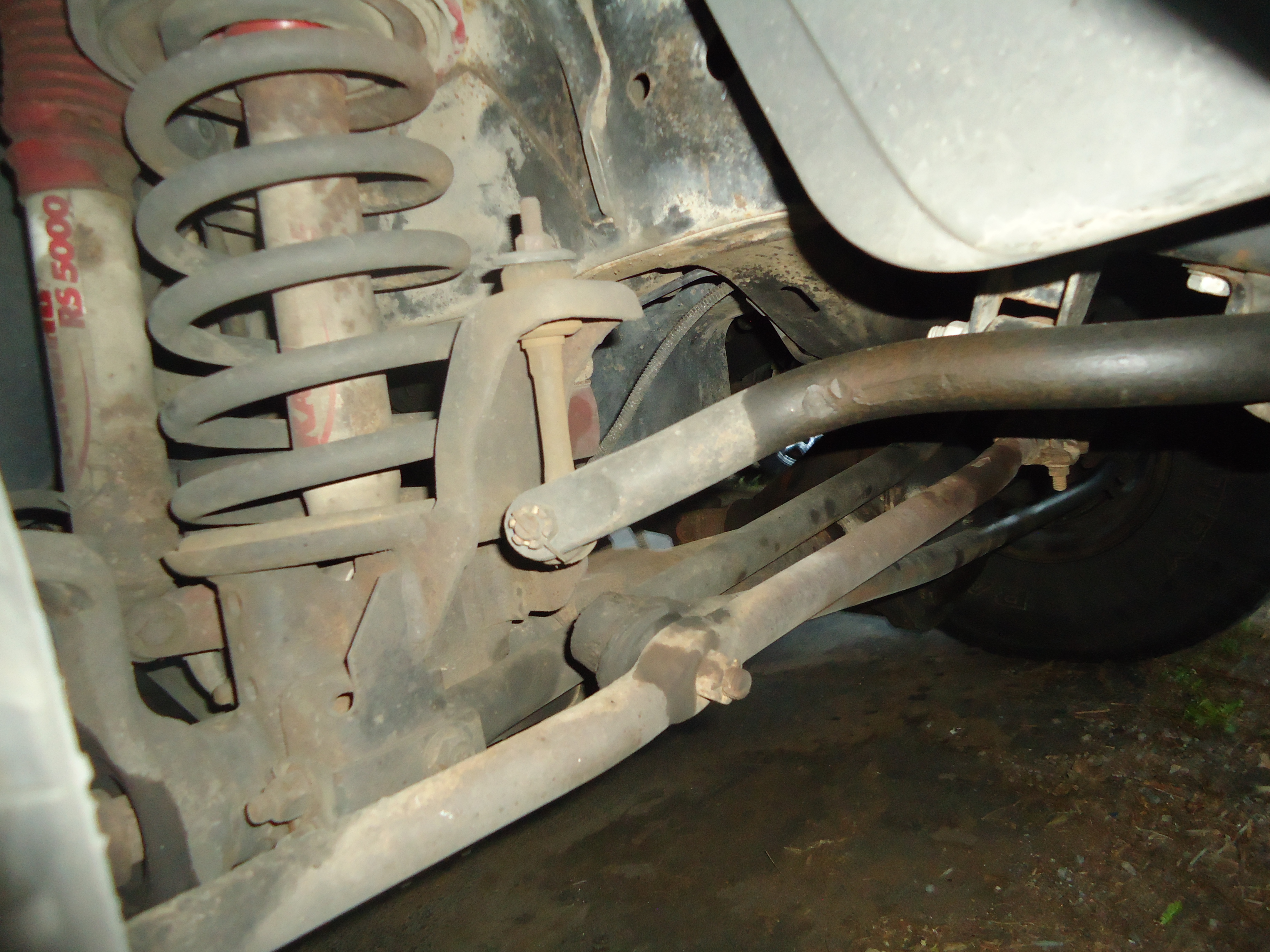

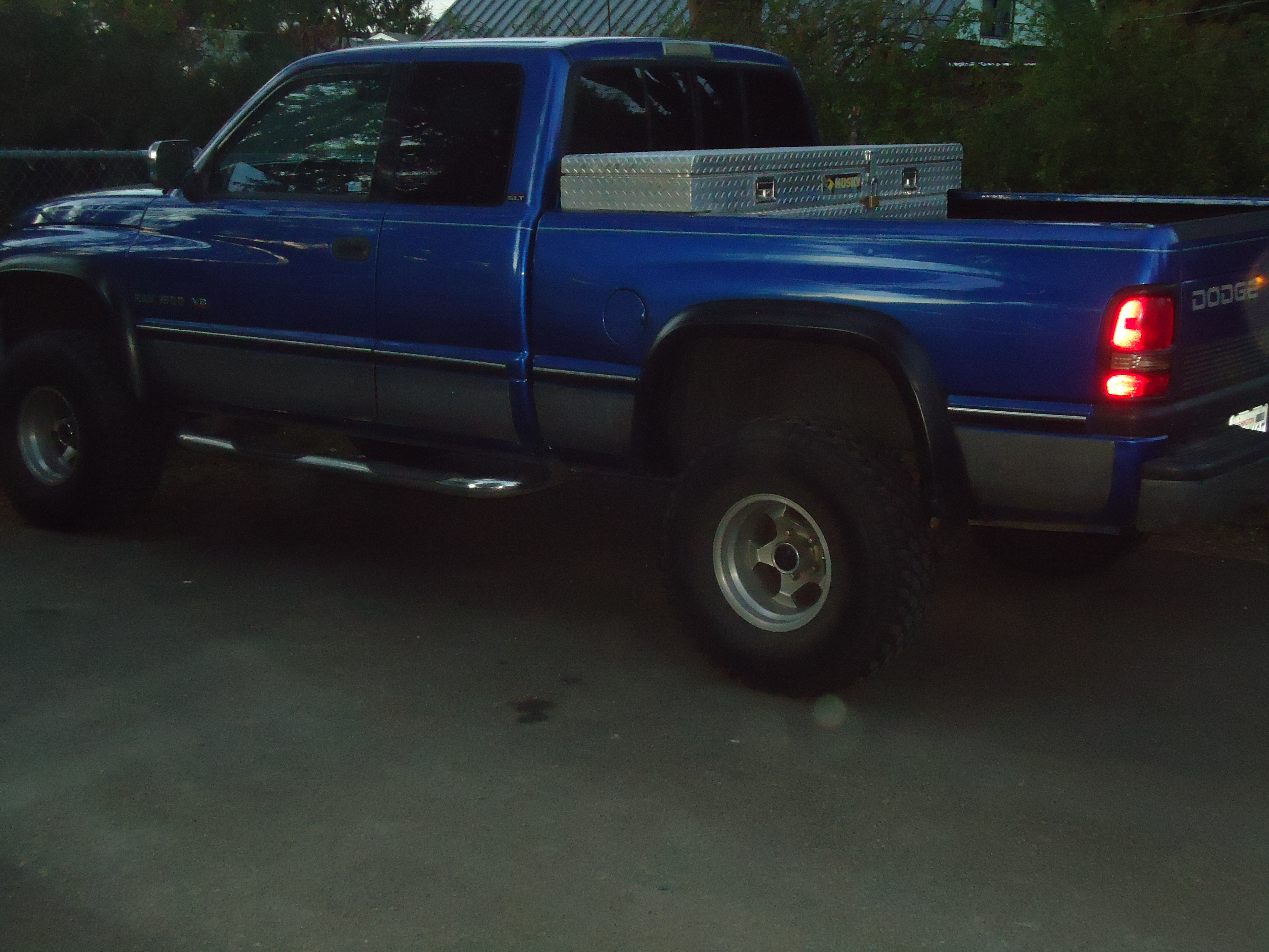

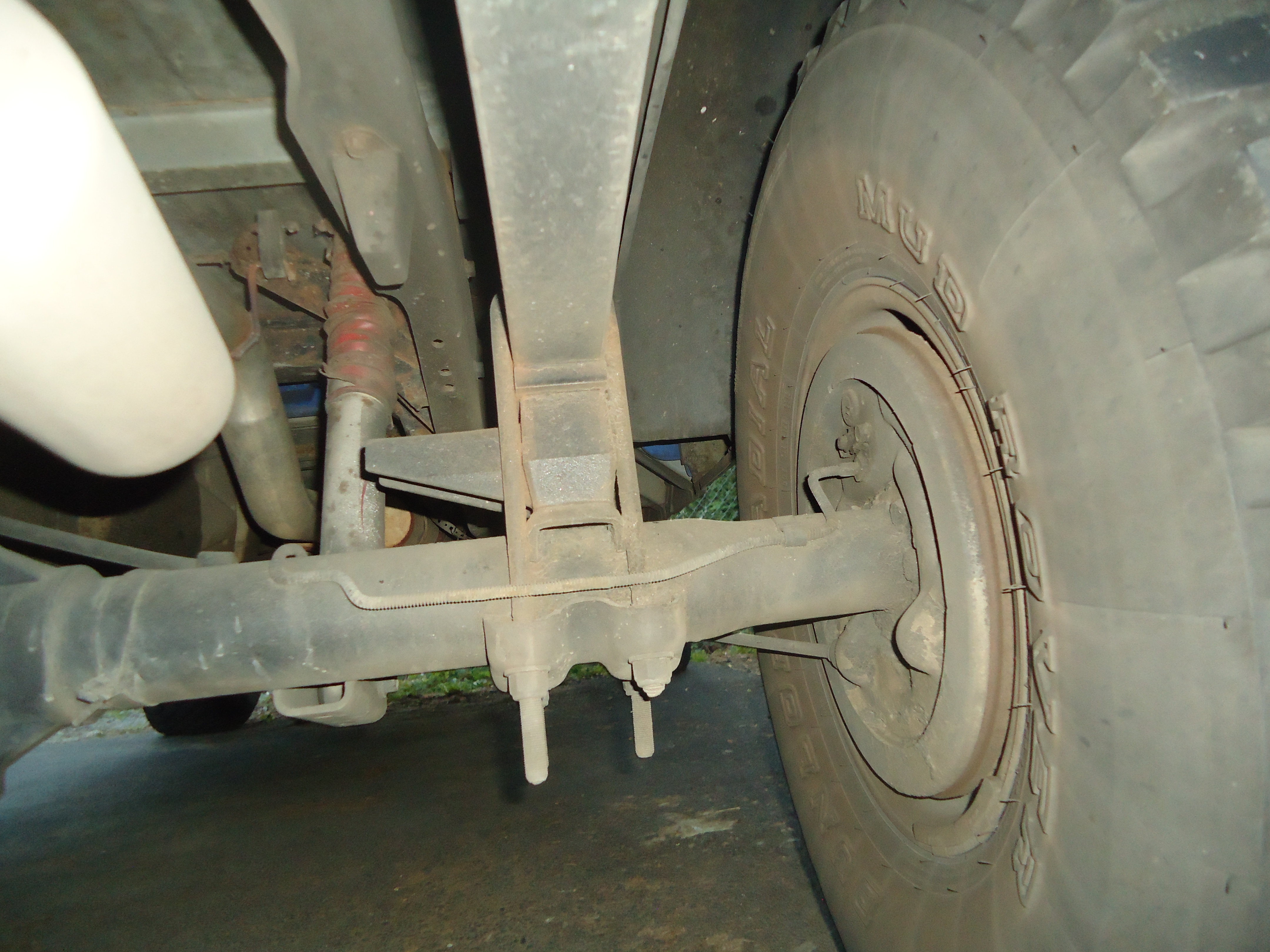

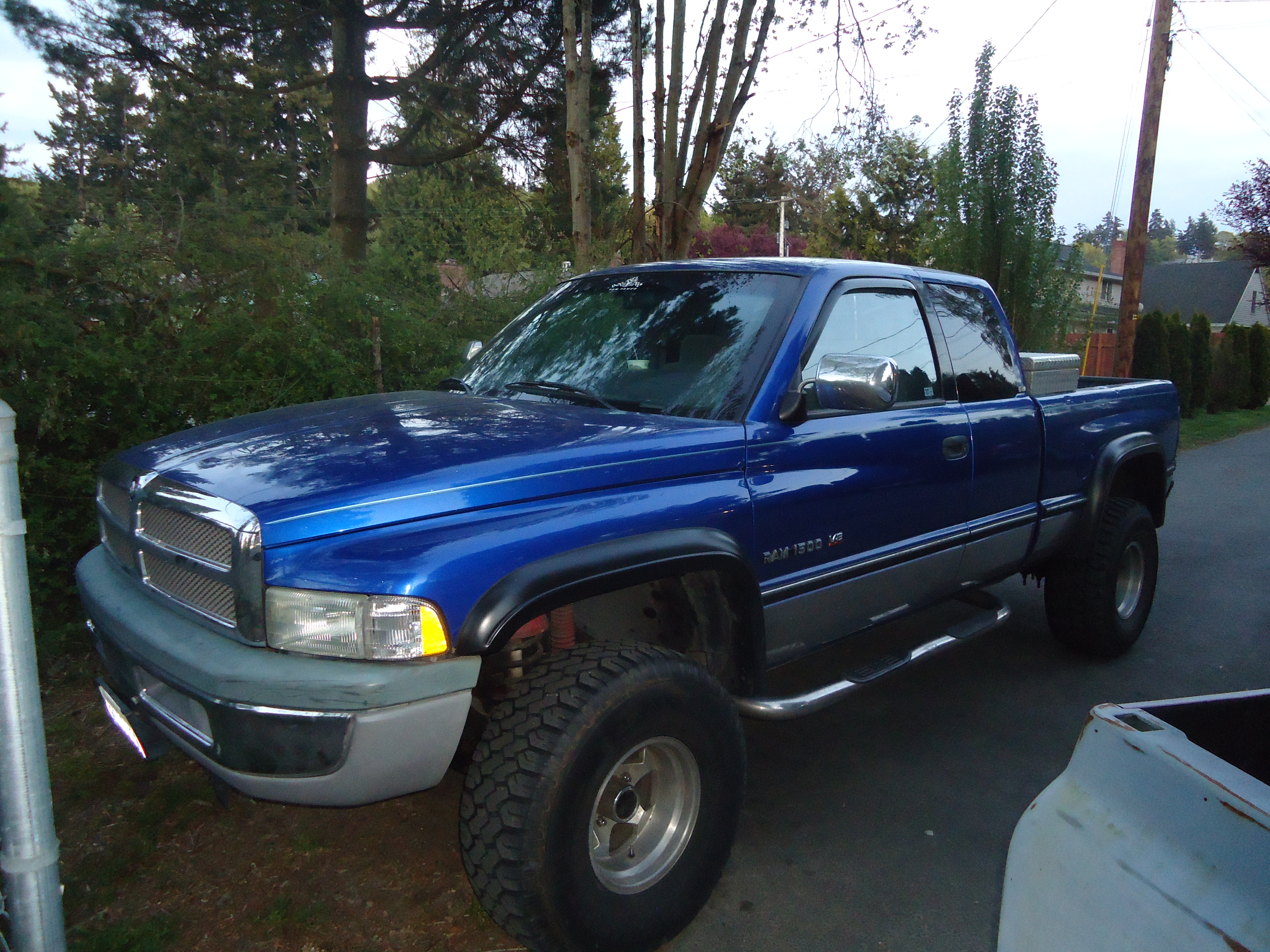

idk if they checked for bent axle or not. ok here is few pics of truck and shocks. i know it looks like crap under the truck. keep in mind i have had it less than a year and have had to dump a lot of money into it so have not been able to get around to cleaning it up and getting some undercoating and all the good stuff. this summer though. im sure its not big deal to anyone but it is to me. nothing worse than a truck thats all BAMMER underneath.
That doesn't look bad at all. Very little rust and things look solid. But I have some concerns:
First off, that is a 97 model, not 98. (Mirrors, body trim, dash, and sway bar links give it away).
Secondly, that looks like a 3" lift, not 5". You can stuff 35s on 15s with just a 3". The control arms are replaced and there's just an AAL out back which looks like my setup. Not sure why dual shocks up front. I also don't see a track bar bracket which is required for 5".
The alignment looks fine. How are your tires wearing? Start with a new track bar (moog will get you by for now) and the other TREs they told you about. Then get under and have your GF slowly turn the wheel back and forth to check for other loose parts. Then align it. If the steering gear has play, replace that too. I didn't notice a bent axle but the pics didn't show that. How about a pic from the front dead on?
