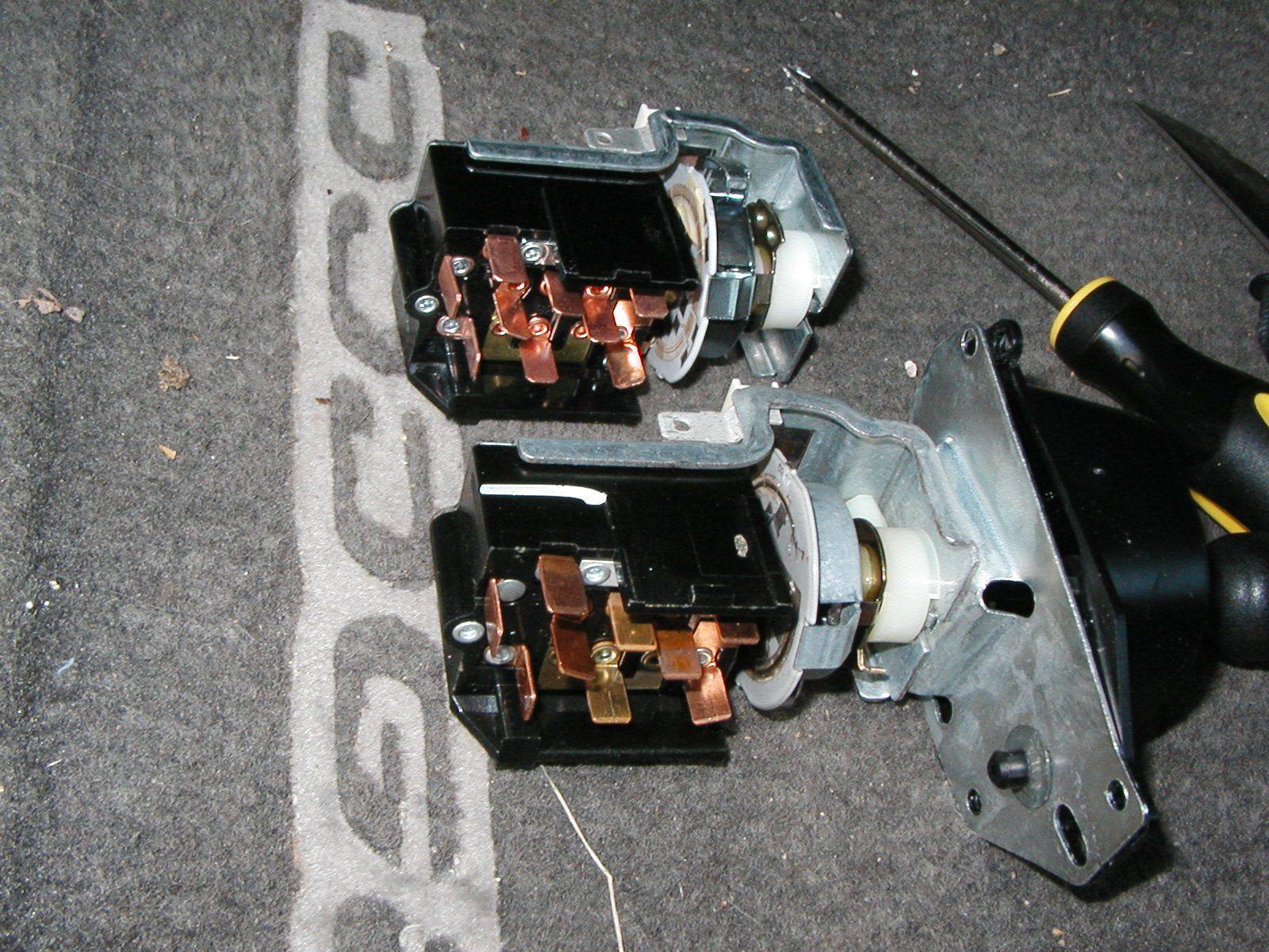

In order that I would replace-
1) Headlight switch
2) stalk switch
3) DRL module.
It really sounds to me like it's your headlight switch, that's where I would start. And, I really don't think it's the DRL module.

sounds like what my Dakota was doing. I would also do the switch first.
do Rams have that little door on the side of dash/clusters ?
there may be the relays in there . Seems i remember that there are gray and there are black ones ...

switches ...

Yes, replacing the switch is a given. But I was also hoping to put in the LMC Relay/Harness kit because it's so simple with its "plug and play". But the DRL's create issues. I'd also be happy to eliminate the DRL's and just have low beams come on with the ignition. Guess I'll just buy a cheap Chinese switch from Amazon and hope it lasts more than a couple months.
