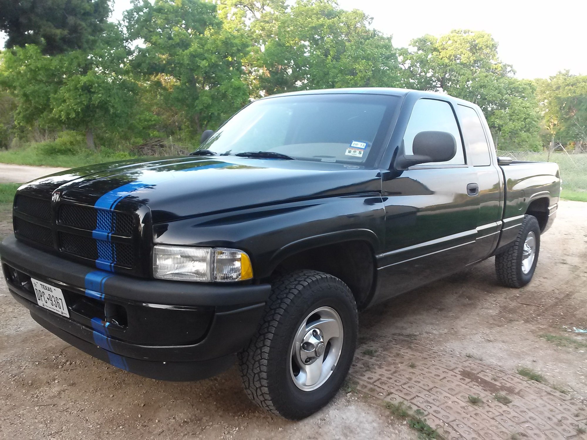

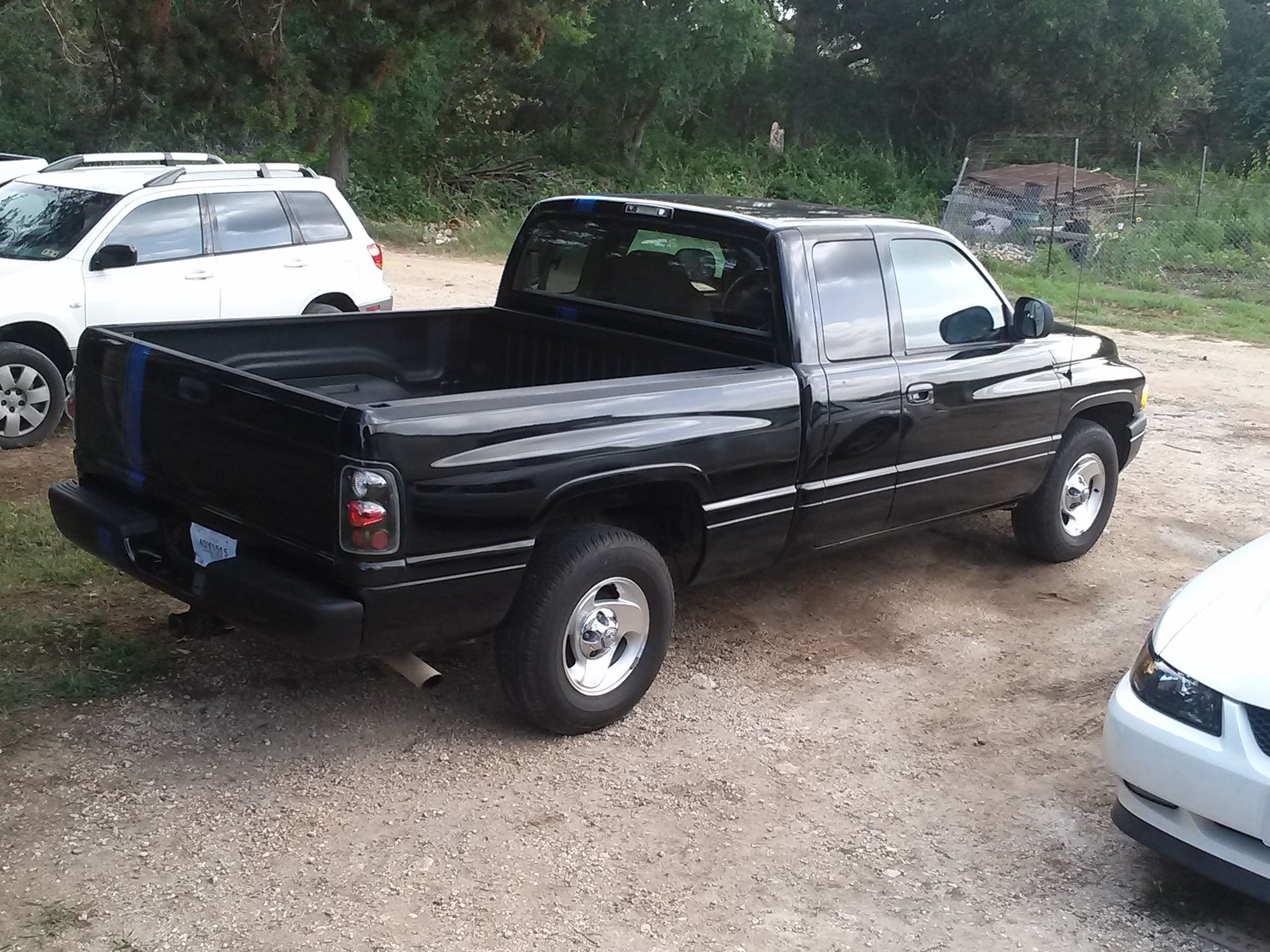

Yea i bought his truck from a car lot in cedar park about two years ago.... I found out he was the PO when i came across the paint job on this forum when i joined last year.
