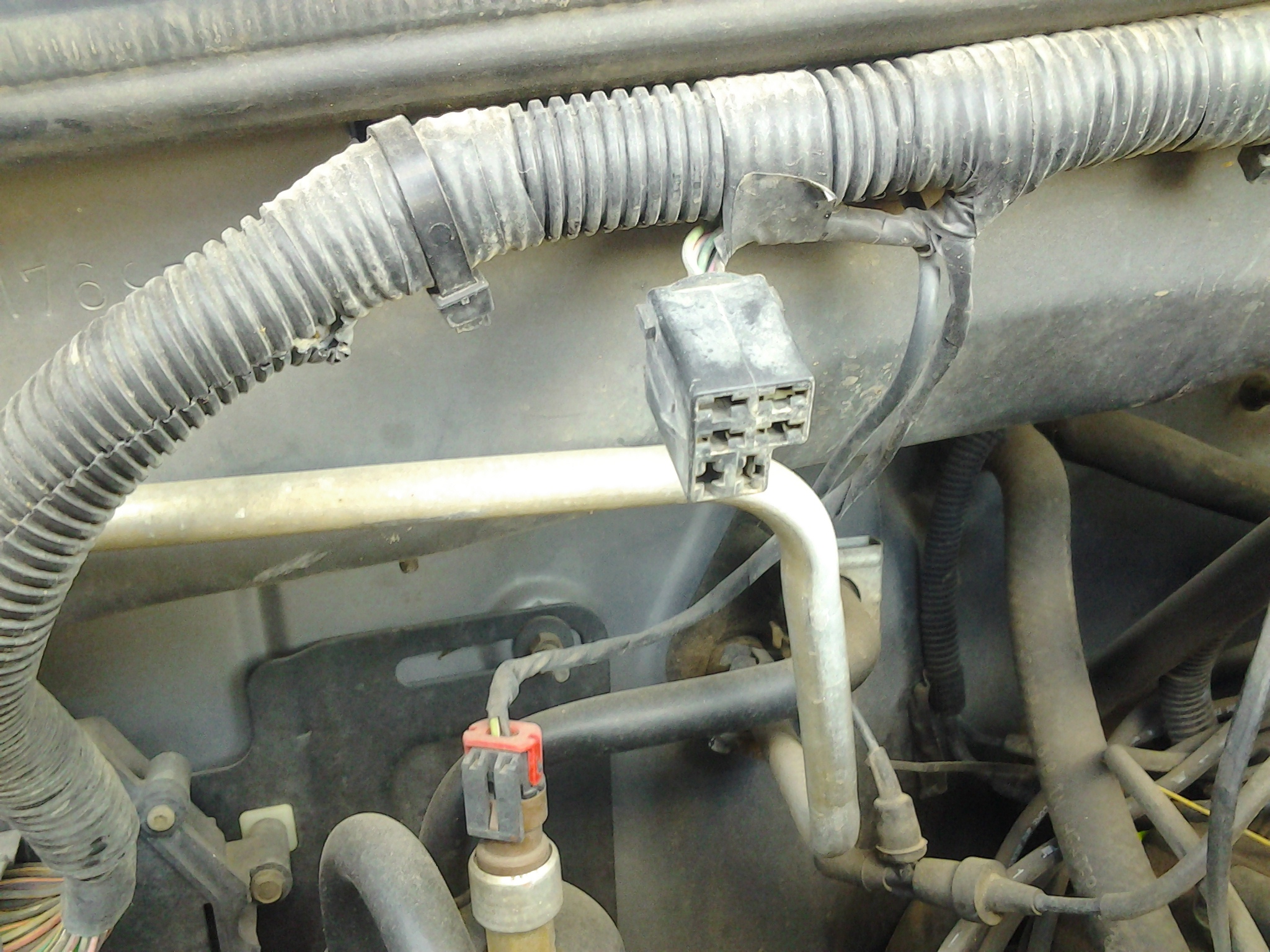

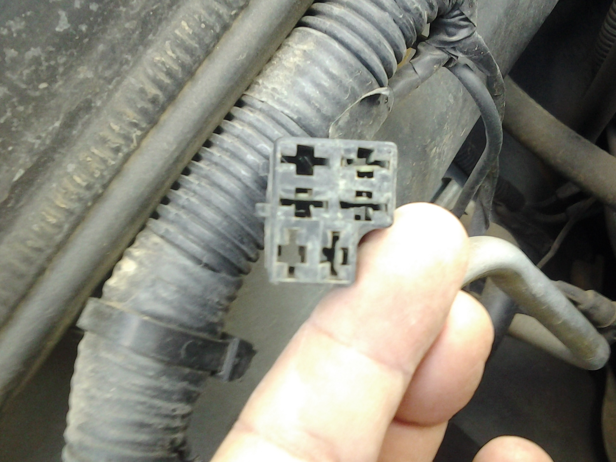

Tonight, I spent the better part of an hour trying to locate a cheap code scanner that will work with a 1995 model Ram 1500, no luck. I also spent an hour trying to locate where you would plug the scanner into on the pickup. It is not under the dash on the inside or anywhere on the outside fire wall that I could find. There is one electrical plug on the outside of the fire wall on the passengers side that might be it but it looks to be a common electrical connection of some type (data link connection) is what one diagram called it. Any suggestions on locating a code scanner for it.

Most of the 'cheaper' scanners are OBDII only. Might have to look on EBay for something like a Snap-On MT2500. It will do OBDI, and OBDII.....
Chrysler didn't put all the OBDI com ports under the dash..... Some had oddly shaped connectors under the hood you had to plug into...... Service manual should tell you where it is.

You don't need a scanner to retrieve codes on a 95.
http://dodgeram.info/Engine-Gas/OBDI/pcm_fault_code.htm
If you want to look at live data you will need a scanner. If you have cell phone you can get bluetooth scanner that will show data on you phone. You are OBD1 so not sure what's out there for that.
