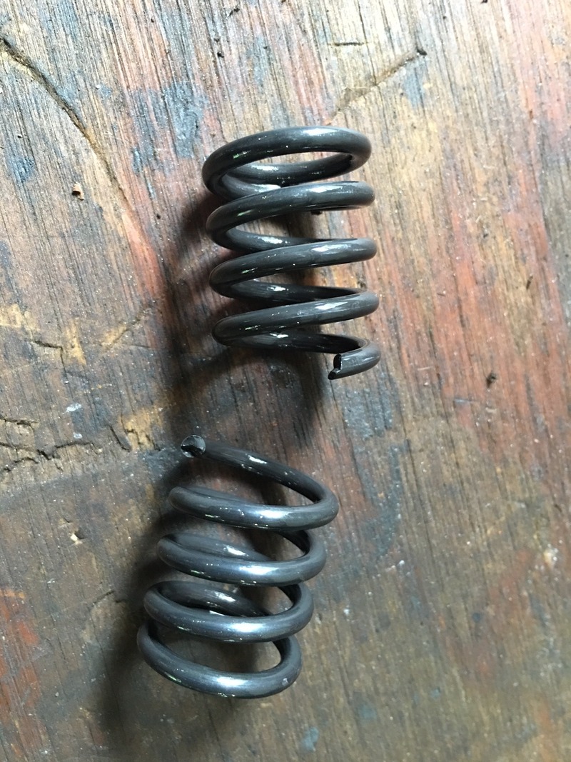

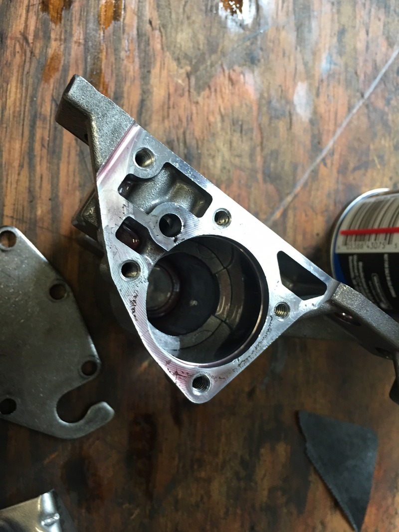

So I dropped the pan and took the valve body down and disassembled it. I did not disassemble it when I rebuilt the rotating assembly because I found burnt clutches and just assumed that was the problem. The truck also had a bent up rear bumper with a cobbled up trailer hitch on it so I just assumed they had abused it by pulling stuff that was far too heavy for it to handle. Anyway, I made some pretty interesting discoveries inside the valve body. The first discovery was a broken spring in the 3-4 accumulator that is attached to the valve body. The spring was broken into two pieces, allowing the accumulator piston to sit bottomed out at the bottom of the bore. The second discovery was a brad rivet inside the main regulator valve bore. I have no F'ing clue how that got in there. This was a one-owner truck before I bought it, the trans has never been into. There was a filter screen on an adjacent circuit that had a hole in it exactly the same size as the rivet head. I swear it almost looks like sabotage. I have never seen anything like this before, ever. I am wondering if anyone else has ever seen anything like this before - knows where that brad rivet originated from. I swear it's completely foreign to the transmission. I can't find anywhere where it may have come from.
Here's a pic of the broken spring:

Here's the accumulator where it goes:

Not possible. There's no way it could get through the filter...and even if it did the next obstacle would be the pump...which would have cratered when this rivet entered it. The only way it could have gotten in there where I found it is if someone put it in there. My theory is that it was placed in that strainer during assembly, then it rattled around in there for 14 years before it finally broke through the screen and got into the regulator valve bore. I did do some checking and it did hinder the operation of that valve in the bore. It limited the travel of the valve, which would have certainly caused problems - e.g. too much line pressure or not enough, not sure which exactly.

I suspect when that rivet got into that pressure regulating valve that it caused a high line pressure situation - which probably resulted in the damage to the 3-4 accumulator and spring. Once that was tore up it resulted in the forward clutch and overdrive clutch packs getting burned up. (The forward clutch also has to engage in order for reverse to work). I am hoping that once I get the valve body put back on with a new spring in the accumulator and the brad rivet removed from the pressure regulator that it will work normally when I put it in gear. I am NOT confident however that it is going to solve the trouble code issue. I'll cross that bridge when I get to it.
