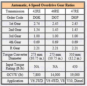

I can't swap the trans. It looks like the 1997 4wd I was thinking of buying has a 46RE and my 2001 V6 has the 42RE. The 42RE does not have the torque capacity that the 46RE has.
I guess there is really nothing to salvage out of my burned up truck :-(
*pic copied from DodgeRam.org

You would basically have to completely disassemble the trans to change it over in any event. So, it would be a pointless exercise anyway. If the trans is still good, you could always just sell it....
