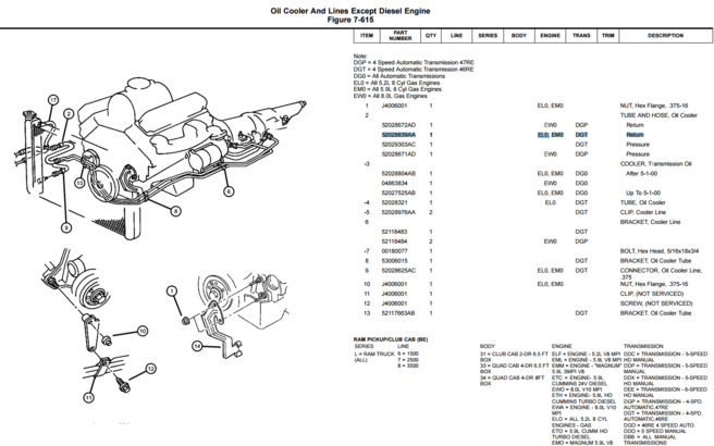

Is getting an OEM transmission cooler return line (52028839AA) for the 46RE pretty much the only way to get a replacement?
No local or my usual online shops don't even have it listed (part# or description of it). I looked at some aftermarket brands (like dorman, edelmann) and they don't have a return line for the 5.2/5.9 V8s, only the 3.6 v6. I had picked up an Edelman brand upper pressure line off RockAuto for like $30 a few years ago.
The return line has the check valve and quick disconnect fitting on it, correct? Would that explain the price? I have the checkvalve deleted and replaced with fittings and a piece of hose, so I don't need a new checkvalve+disconnect.
Also the brackets holding the lines are pretty much shot, rusted away. When I've been to the junkyard I've tried to find a truck that wasn't rusted but they're usually in the same sad state my truck is in. I don't really want to spend much on this 15 year old truck so would zipties+rubber as a bushing, and keeping an eye on that every now and then be sufficient for the trans lines? I don't want to half-*** it but I don't want to spend big $$ at the dealer.

check valve is in the line going TO the cooler.
Why do you want to replace it?
zip ties, and insulators will work fine.

I live in the salt belt. The line is disintegrated and started pissing fluid all over the place. I don't trust wrapping it up. I don't want that crap in my trans.

Ya might just buy some hard line and fittings and create one yourself.
Old May 28, 2016 | 06:54 PM
Posts: 87,561
Likes: 4,231
Yeah, the tubing is very easy to bend by hand, and the cool tool to help you along is only a few bucks.
