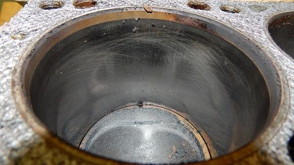

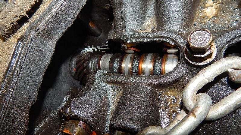

You may want to take a close look at everything in a 200K motor. This is from a motor with 190K according to what i was told. Note the lobes especially the last one!
Slight scoring in the bore.
I bought it to rebuild so no biggie.
