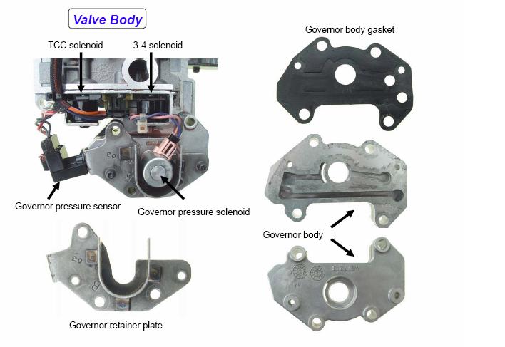

This looks like what I might call a "solenoid pack."
https://cobratransmission.com/soleno...FUVhfgodNDsOXA
No, that's the governor pressure sensor / solenoid. What I'm speaking of is on the other side - the top side - of the valve body.
& dbb1 That's the TCC Solenoid / OD solenoid. One of the possible causes but less likely than tha aforementioned mystery solenoid.

Shifting issues are unlikely to be caused by the O/D and TCC solenoids, if those go bad, you simply don't get whichever one they control.
For general shifting issues like you are seeing, that sounds a LOT like a failing/plugged governor pressure solenoid/sensor. Various folks make 'heavy duty' versions, that you can get off EBay for around 100 bucks.
Wanna test? Crawl under the truck, and unplug the 8 pin connector, 'bout halfway back, on the drivers side of the trans. This WILL set codes. Go for a drive, keeping in mind that your trans will have ZERO automatic function. It will stay in whatever gear you put it in. So, start in first, accelerate slowly, shift to second, then third. If the trans shifts into the gear you tell it to, when you tell it to, replace the governor stuff. If it doesn't, highly likely to be rebuild time.

Sorry, my old, feeble mind wandered while reading your post. I re-read it again after taking some brain-viagra (coffee). You're looking for the "shift" solenoids. Gotcha. Now what was I doing again???
