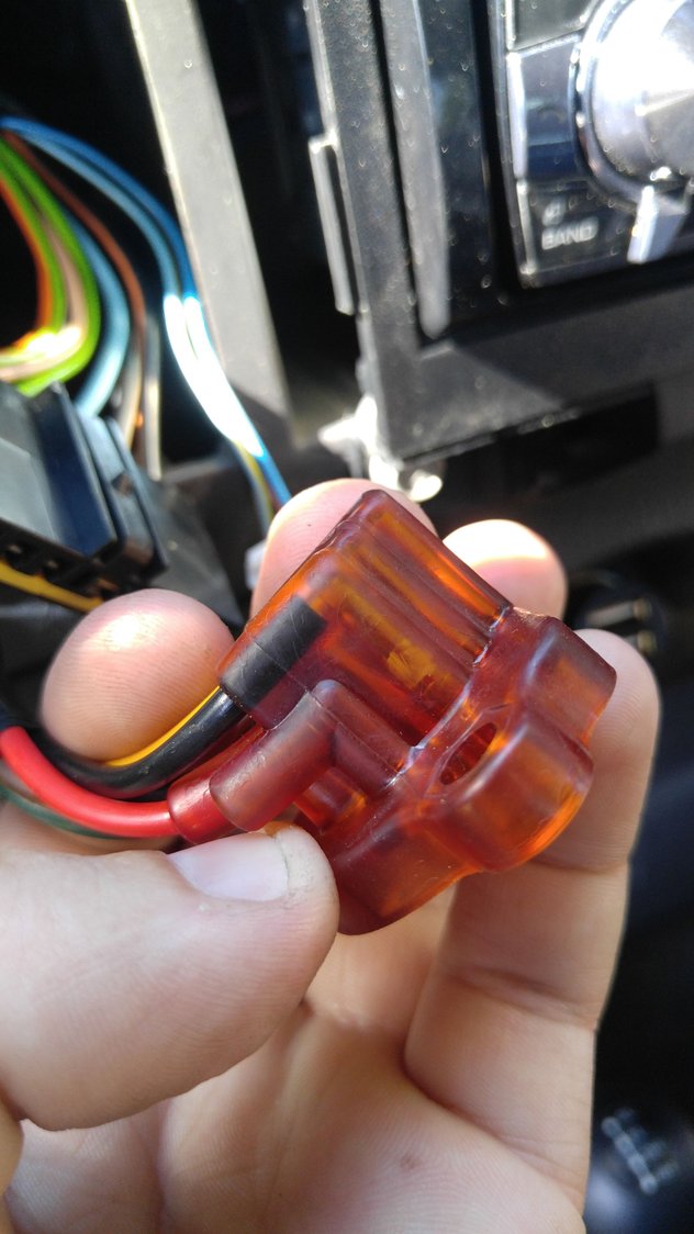

Old Jun 17, 2016 | 06:11 PM
Nate_rs's Avatar
Nate_rs
Joined: Oct 2013
Posts: 237
From: Northwest Texas
If I pull the vacuum line that goes into the firewall and try and blow into it nothing gets through.
This is the little plate inside the black "thing" that all of the vacuum lines hook to one the back of the AC controls
I'm thinking some of that gunky **** may have gotten sucked through that black vacuum line and clogged it
Thoughts?
Old Jun 17, 2016 | 06:14 PM
Nate_rs's Avatar
Nate_rs
Joined: Oct 2013
Posts: 237
If you look where the black line goes into the orange thing there is some white residue where it looks like some of that stuff has been sitting...
Old Jun 17, 2016 | 09:08 PM
Posts: 87,362
Likes: 4,209
See if you can clean it out. Then check and see if you actually get vacuum there.
Old Jun 17, 2016 | 09:19 PM
Nate_rs's Avatar
Nate_rs
Joined: Oct 2013
Posts: 237
Is that black line in the back of the orange connector the same line that comes through the firewall?
Old Jun 17, 2016 | 10:01 PM
Posts: 87,362
Likes: 4,209
I do believe so.....
