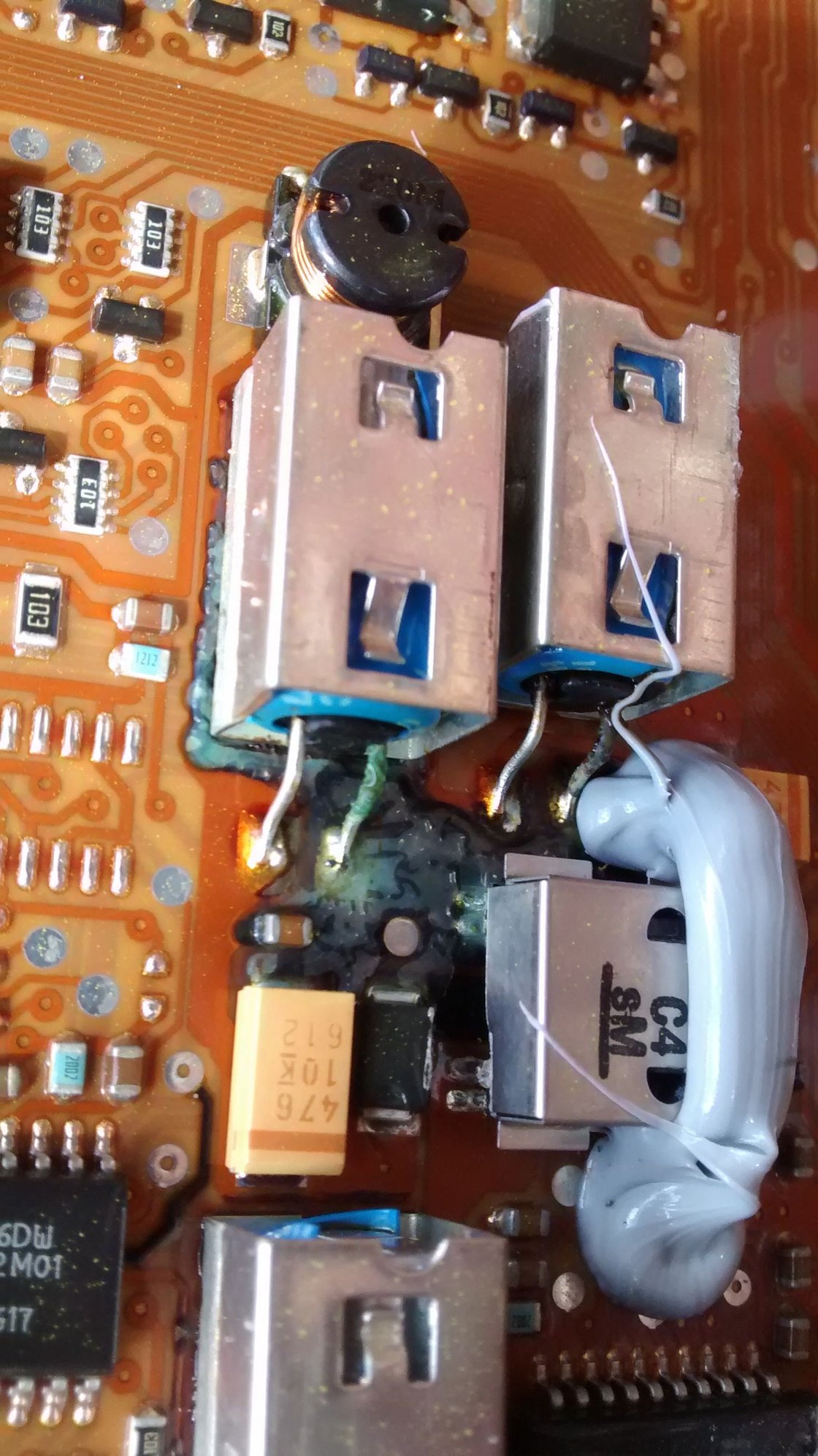

I decided to take a look inside the pcm. mabey this is my problem? It looks to me like a capacitor has gone bad, from the green stuff on it and the black all around it. Do I have any options , as far as repairing it? Ive heard of it being done, but is it worth the trouble, givin the odds that it will last? I guess I could afford one from a salvage in a week or so, but a new one is way outta my budget.

Does the PCM just come apart after you remove the screws ?
You could just get a new capacitor, for a few bucks, it may be worth a try. Just get the same values.

It doesnt pop open real easy. kind of had to pry a little, and it was sealed with some kind of epoxy or something, but I was pretty carefull not to break the board loose or damage any thing. I guess there should be some numbers on the caps, but I have no idea where to order them from. Im going to inspect the board real good with a magnify glass today too, because Im a little concerned about the black color around the cap on the board itself. I may end up purchasing the whole unit any way... but I have an obsession with trying to fix things most folks would toss out.
