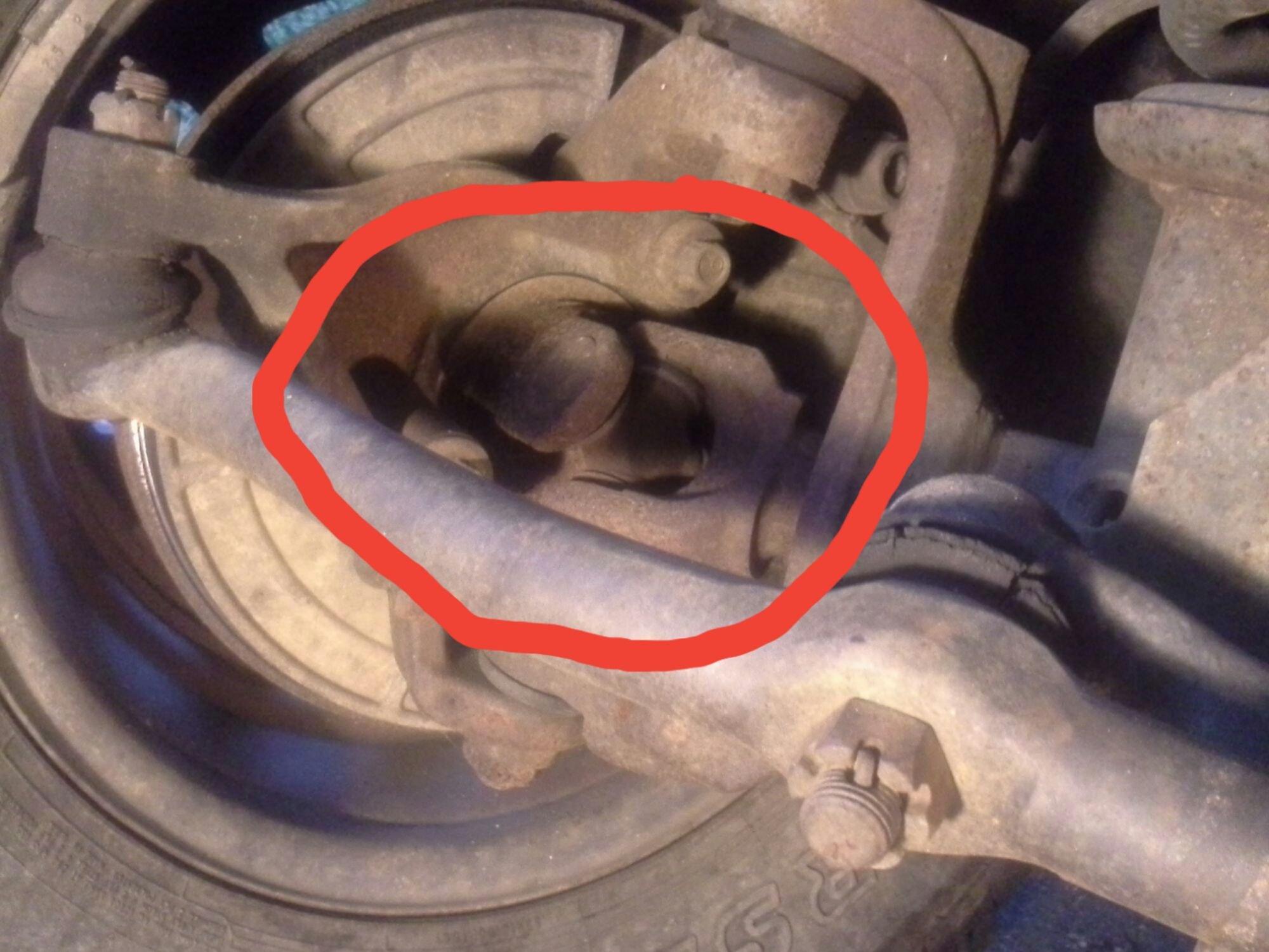

Old Oct 20, 2016 | 08:41 PM
  #30
frankie_b_jr's Avatar
frankie_b_jr
Joined: Sep 2013
Posts: 586
Likes: 17
From: Nevada
The sloppy steering parts can make it fun running down the road. Good idea to change them as stated.
As for the binding, I circled the suspected trouble point in your picture.
These spin whenever the truck is moving.
These U-joints like to dry out and bind as they get older. They will do exactly what you were describing orignally.
Sounds like you've got some work ahead of you. Once all of these things are done you'll have an awsome truck for a long time.
