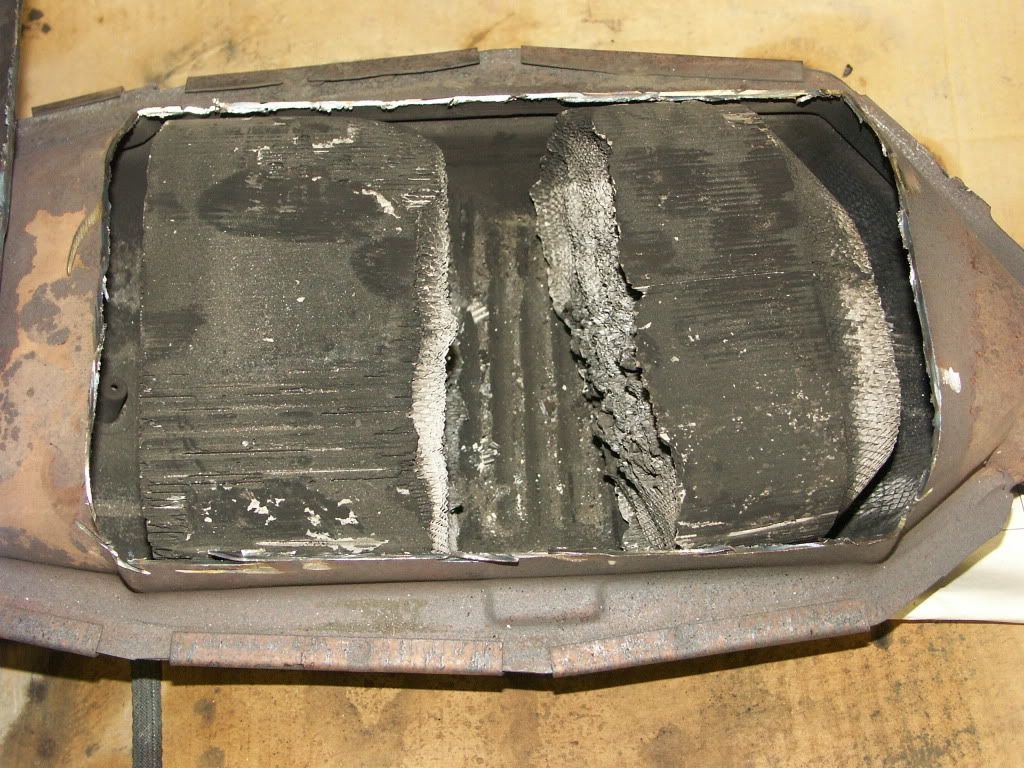

While I do not condone this at all (and its federally mandated equipment), some just cut a hole in the cat too. Then weld on a patch.

Have to be big patch if it's factory. This was replaced by a magnaflow 23285.
