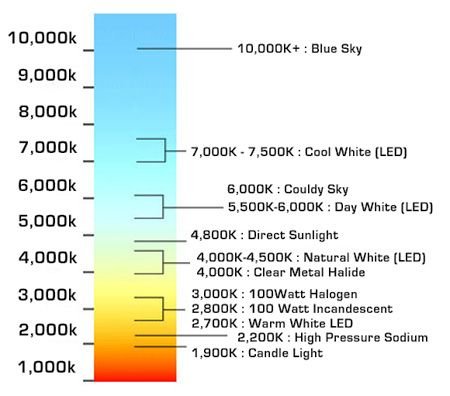

Yea, And no bad cell phone pics! I would like to see one side left with the oem and the other with the led's for a good comparison. Hard to see the differences when taken with both at different times. Can't really compare led to halogen, Two different color spectrum's (kelvin) even with the same output.

I'd also like to note that I've had those same SuperBrightLEDS bulbs and compared to now they might as well be stock. I also don't have a stupid obnoxious glare anymore and no more getting brighted or pulled over.
The SBL bulbs are rated at 3200lumens on high, not 6600. The 6600 is the temp color range. My HIDs are 6500k (kelvin, it's the color scale posted above) but being 50w instead of the standard 35w they come out to being more like a 5-5300k thx to the increased power.
