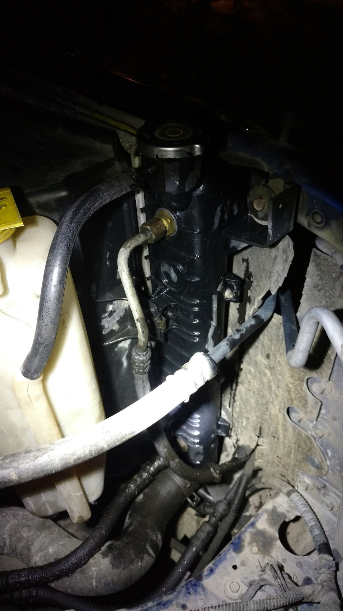

Forgive my late reply... There is coolant in the overflow as well as the rad... However for a better view this is what I see. Now trying to figure out where and why it happened. To be fair it is-7 or -17 with windchill hence my hesitation to go outside and try to figure it out atm.

Looks to be coming from the rad cap, take it off and see what the rubber seal looks like.
