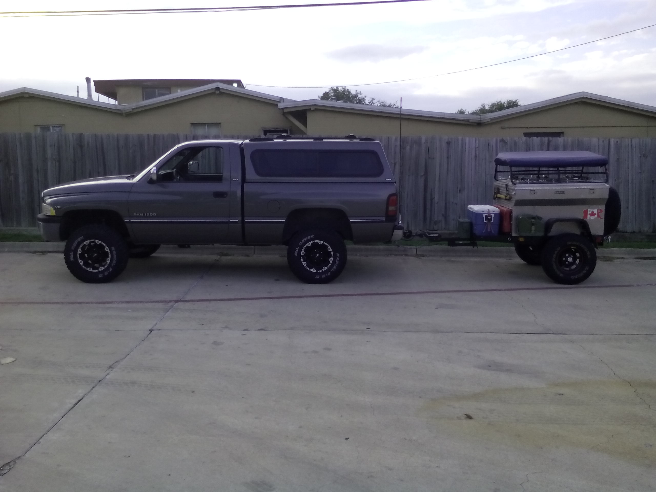

Two inch coils (or spacers) up front, and a 2" lift add-a-leaf in the rear easily clears 33" tires (or 285/75/16" tires). It doesn't make a noticeable (negative) difference with the front control arms or track bar either.
