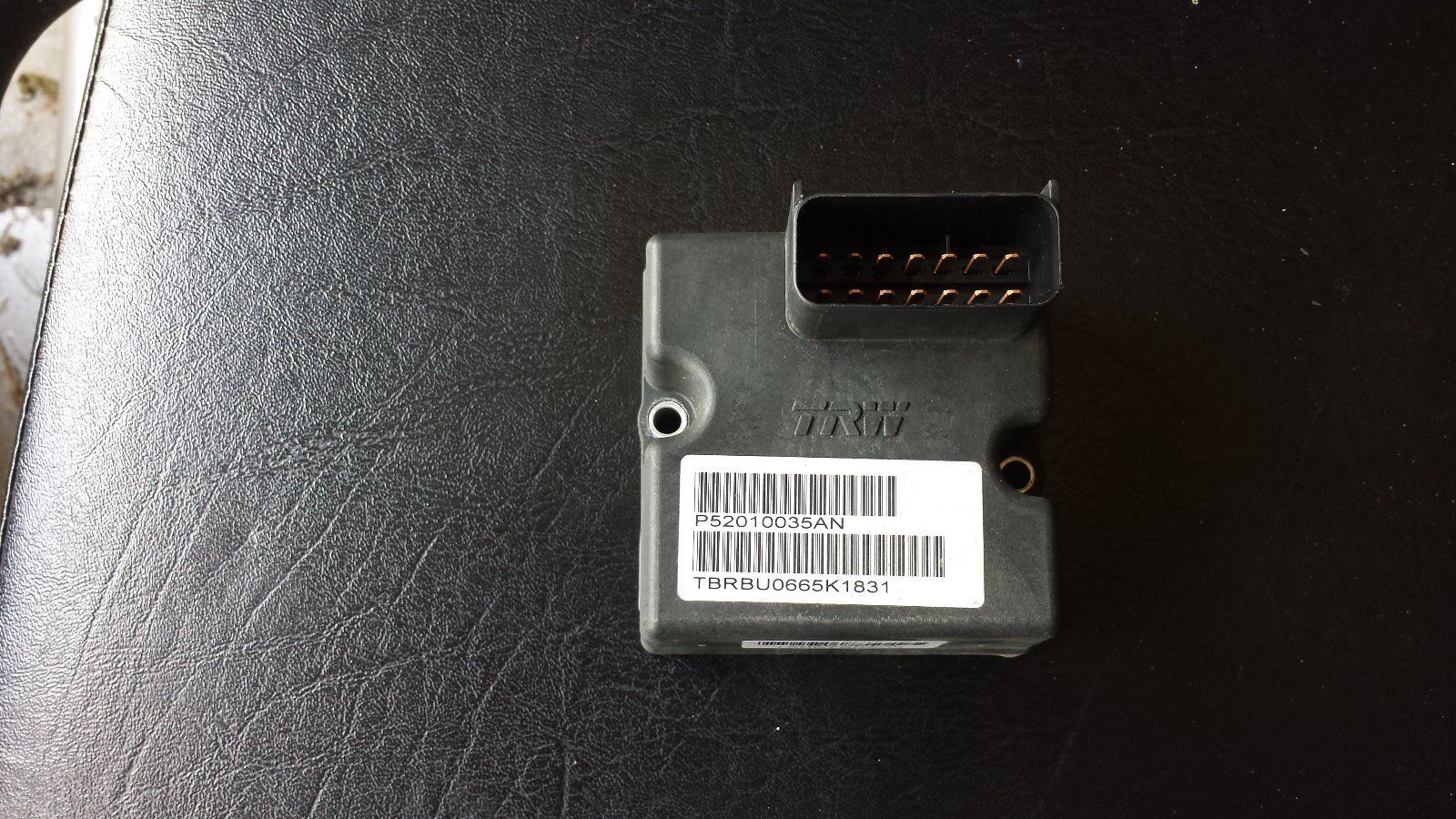

Old Jan 13, 2017 | 08:47 PM
TNtech's Avatar
TNtech
Site Moderator-Dodge Tech
Joined: Sep 2010
Posts: 3,724
Likes: 22
From: Nashville, Tennessee
NM that was from a 2004...derp
