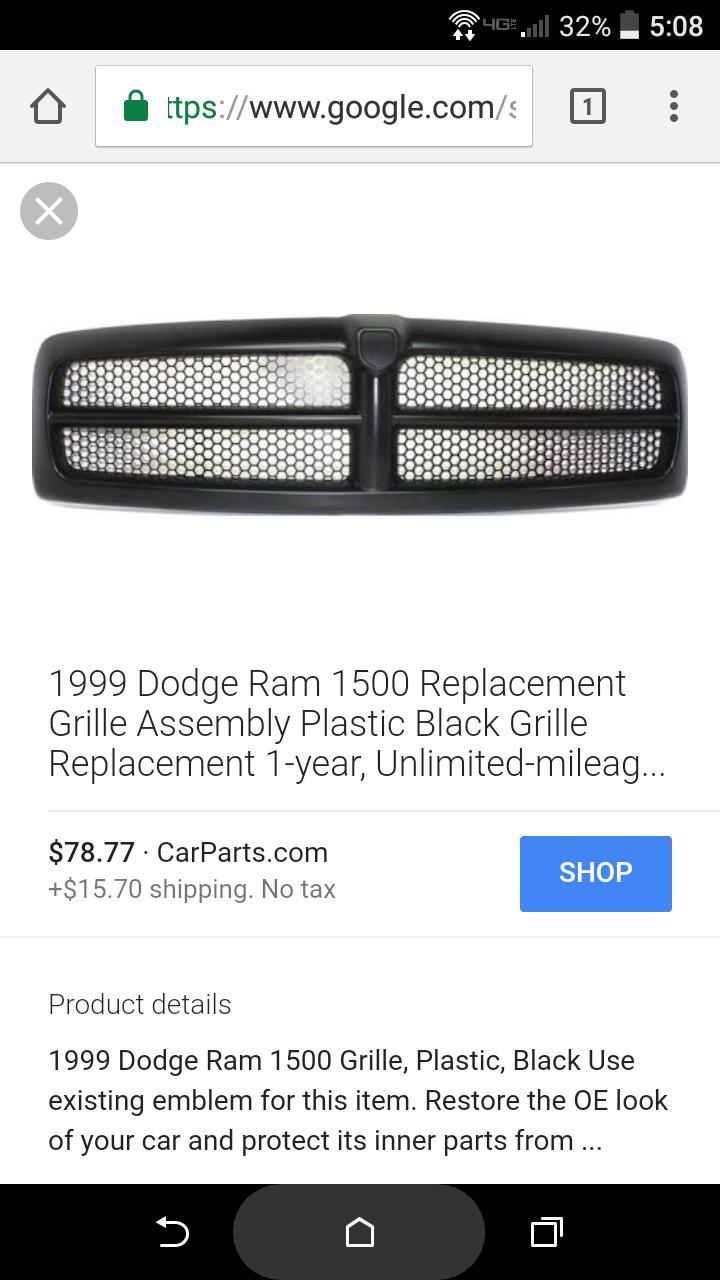

Default New additions
Originally Posted by Mike 84
My name is Mike and I have a 1999 Dodge ram 1500 Sport with the 360 or 5.9. I joined this forum because I've kinda grown attached to this particular truck. Basically I would like build ideas both mechanically and cosmetically. and coincidentally I am I the market for a new transfer case. I know my truck has a chain driven (tc) can I put a gear driven (tc) and if so what is the model number and or name and or yr/make/model of of the truck with a compatible gear driven (tc) 99 Dodge Ram 1500 Sport 4x4. 5.9

Skip the throttle body spacer. It doesn't do a darn thing for our trucks, aside from lighten your wallet.
Cold Air intake isn't really a good 'bang for the buck' mod either. It draws air from the exact same place as the stock system, even with the funky tube running to the front of the engine compartment. If you were building a high revving motor, I could almost see it, but, for a truck, a free-flowing air filter in the stock housing is just as good, if not better. (as it doesn't cost an arm and a leg....)
Might wanna consider larger tires too. I think stock was 245/75/16??
What's the end goal here? (did I already ask you this?? )

I did get bigger tires the picture is just meant to show the brand and style.
