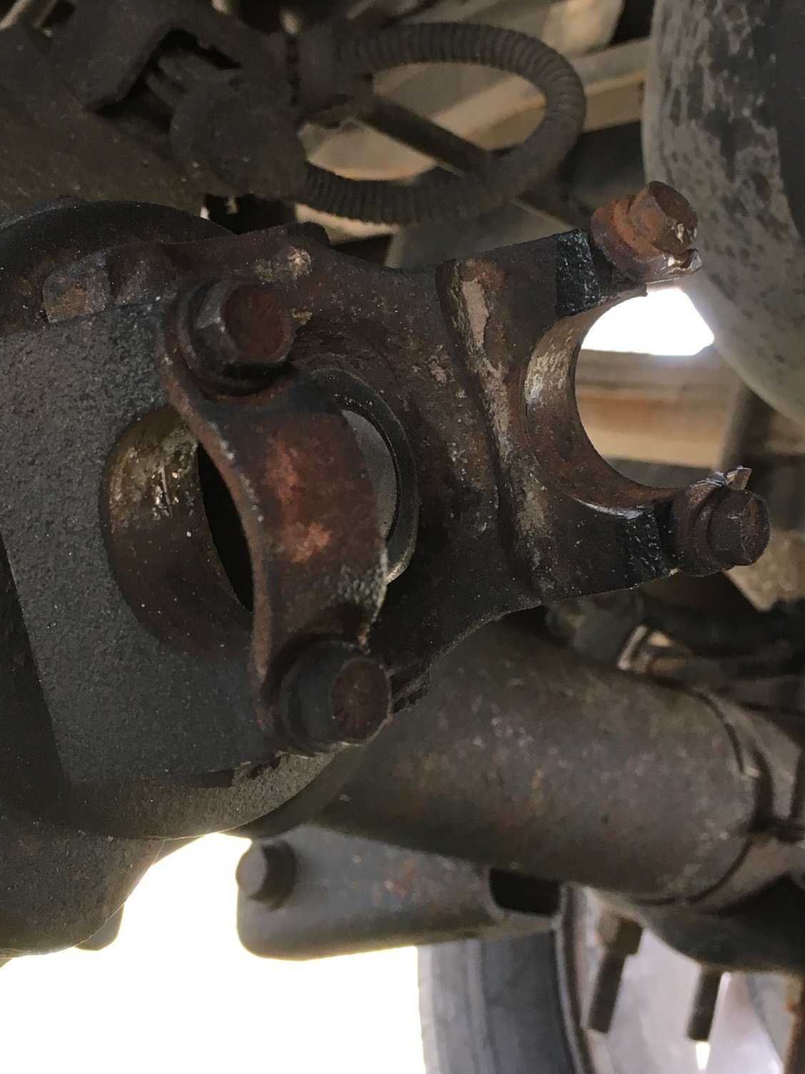

Front diff
Front diff

Looks like the front shaft had its u-joint wiggle out when that bolt on the strap broke and punched the transfer case rearward when it hit the ground.
Did you have the front gears replaced? that Pinion nut doesn't look like it's been touched in years.

Only rear gears were done, was planning on having the front done next month.....so currently im looking at replacing the overdrive unit of the trans rebuilt off ebay, replacing/having rebuilt the transfer case, driveshaft, straps and u joints and selling the truck. I figured I would get more for it running then as it sits right now in a storage unit. When I start the truck and put in gear, the output shaft spins likes its supposed to and doesn't seem to be anything wrong with the transmission.
