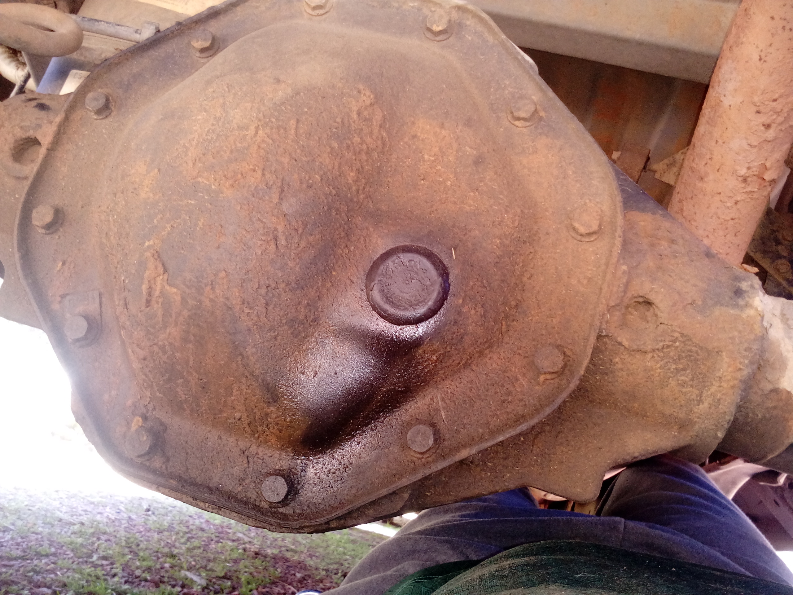

Well I need a new Rear End for my 2001 1500 Laramie 5.9L 2x4 SLT Long Bed Club Cab. I got a build sheet by looking up the VIN and it says 3.55 ratio. I found this website but don't know which ones will work: http://www.automotix.net/usedautopar...c4ee&seq_num=3 Some cost more than others and some says different engine liters. I want the cheapest one that will work with the truck. Also, is this just an axle or does it come with the differential too? Cause I would be upset if I ordered it and the differential is not there LOL. There is one that says in the description "4X2 LOCKING" and I don't know what locking means. Would that one work if I ordered it?

So, you have 3.55 gears. Since you are a 4x2, now would be the time to change your gearing, if you so desired (for bigger tires, towing/hauling, etc). You have a corporate 9.25 axle. 5.2 or 5.9 engine should not matter, I'm not even sure it matters if it comes out of a 4X4 (shouldn't matter on the rear axle). Technically, any 9.25 should work, as long as the width is correct, but...
If you get one from a 1500, it should bolt right up. Otherwise, it may require moving spring perches, shock mounts, etc. At this point, you could probably even move to a Dana 60, if you wanted.

So, you're saying I don't need a 3.55 gear ratio and I can get any ratio and it will work and fit?
Old Mar 21, 2017 | 07:57 PM
dbbd1's Avatar
dbbd1
Joined: Sep 2015
Posts: 1,552
Yes.
3.55's will get you good (relatively) gas mileage. It will be harder on the trans and drivetrain.
4.10's will be a good compromise.
4.56's if you have bigger tires or tow a lot.
