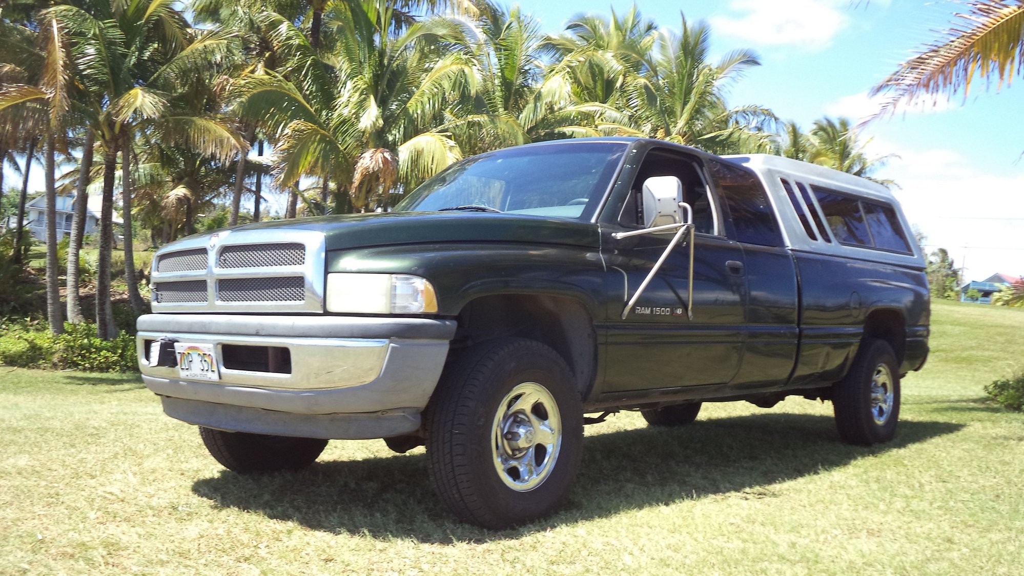

I have already begun a light restoration project. Ready to invest a bit more on this Ram.
Motor runs solid, burns some oil heats up going over high passes..
Transmission shifts very smooth, must have been replaced at some point.

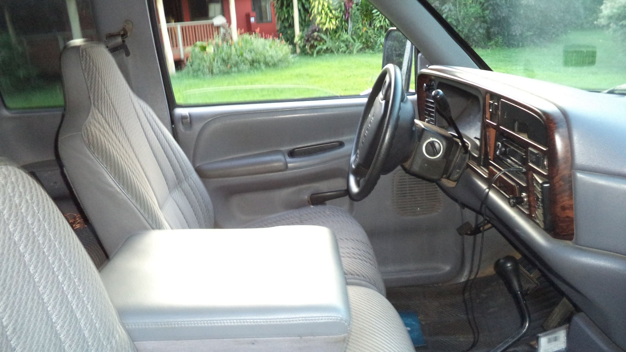

Interior is nice, I put a new dash, steering wheel windshield, headliner and had the arm rest and driver seat reupholstered
I know the old adage if it's not broke don't fix it..I took it to the Big Island and it ran great! This winter I want to take it down to Baja and need it to be dependable..Below is a list of what I have already done..

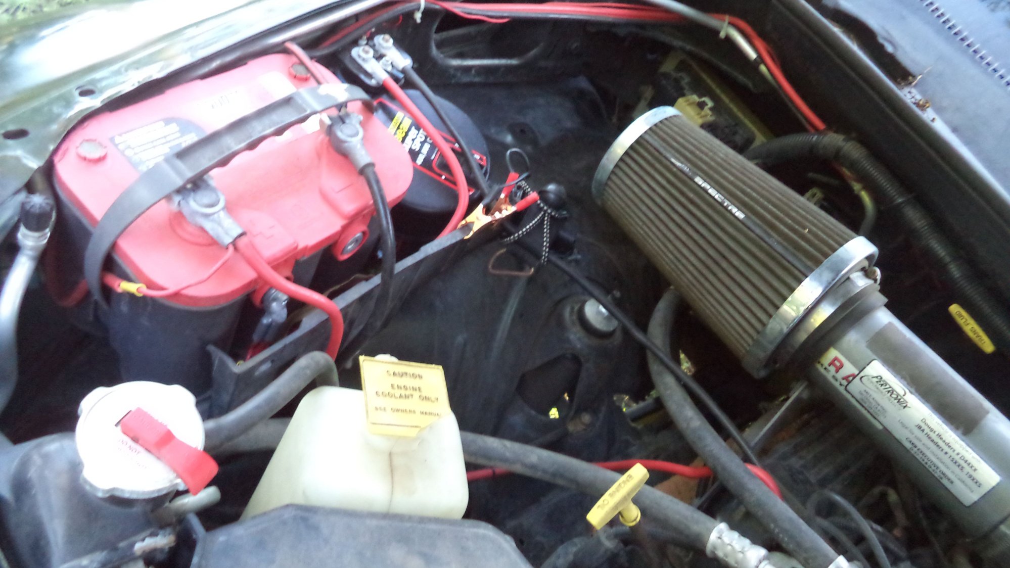

Cold air intake

Seats, what years will fit without modifications..would like some bucket seats and get rid of the old ones..

I put in a Second Deep cycle battery to run a 2000wt inverter

Seats from 94 to 97 will bolt right in.
