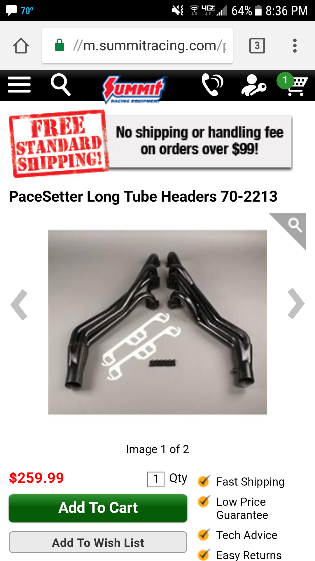

Alright yall, since im still learnin about mopar motors, maybe yall can help me out. I put long tube headers on 2 of my old fords with 351s. Both really didnt give me any noticeable difference in power. But, ive heard from a couple mopar guys that the magnum motors respond great to headers. So i went on summit racing, like any bored redneck does in his free time, and found these. Has anyone had any experience with these? I like the 3/8 flange thickness, i had thinner ones on my ford and they warped, and these are 1 and 7/8 inch which is pretty good for the money. Has anyone used these in particular? I really want to improve my throttle responce and mid to high range power. Also, is there any better headers out there for a 98 with a 360? I definetly want long tubes tho. Thanks for yalls help.

Those are the same headers I recently installed on my truck, with the matching off-road Y-pipe. Here is a link to my thread...
https://dodgeforum.com/forum/2nd-gen...-the-97-a.html
They made a huge difference for my 408, but you will probably notice a little loss on the bottom end of a stock engine.
A better (but much more expensive) option is some tri-y headers. They work better throughout the rpm range rather than concentrating on the top end (long tubes), or the bottom end (shortie's). Just my 2 cents worth at least.

Headers won't help you with throttle response. For that you want 52mm throttle body (increases throttle sensitivity) and gears (more power due to engine rpms being in the correct range)
