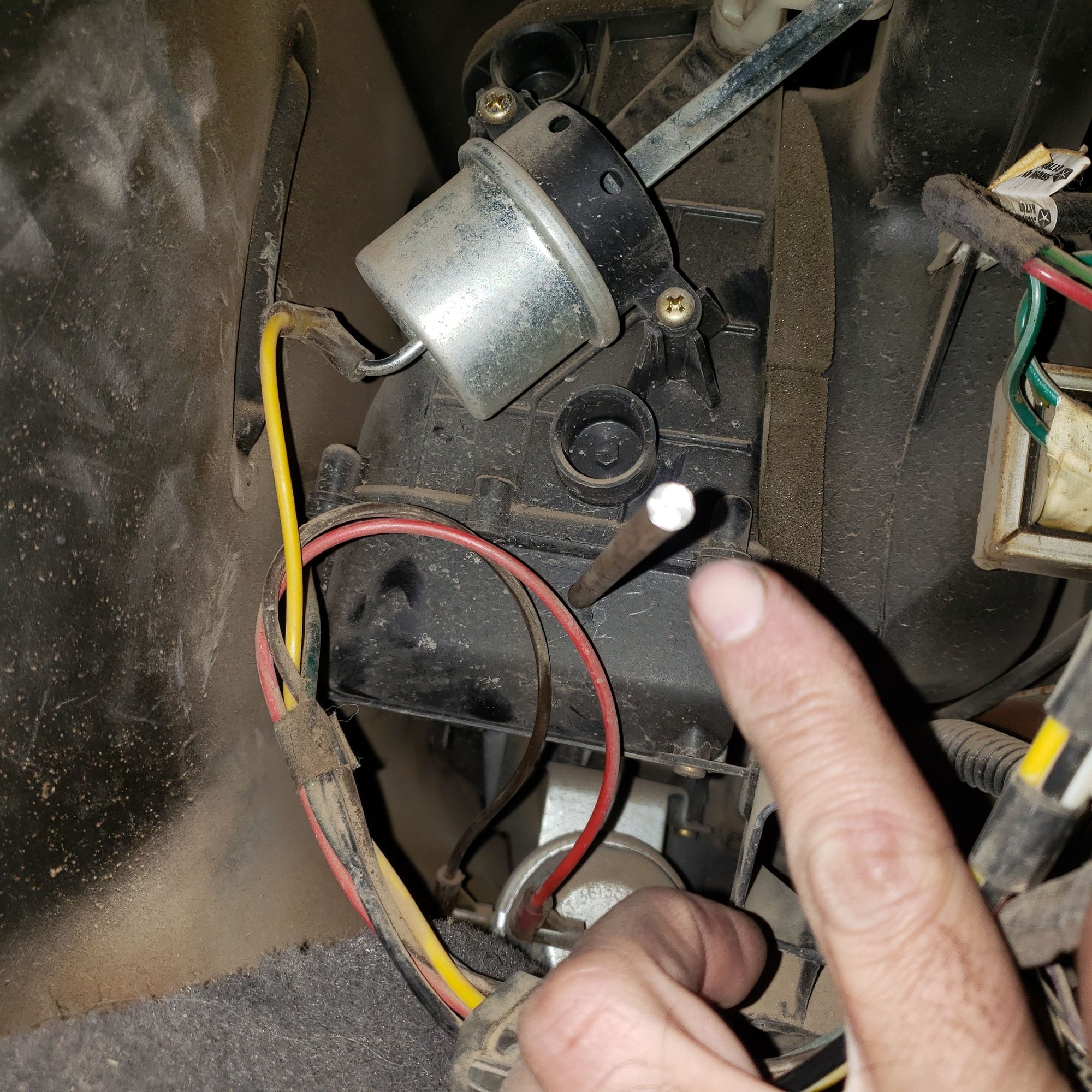

So OP covers the issue of floor-only air flow at about 2:00 in his video in Post #1.
I recently took a different approach to our beater '98 Ram. First I verified the vacuum actuator for this door was indeed 1) connected and 2) moving. Everything you can see is working as it should but it wasn't moving the flap internally, so broken door basically.
I drilled a ~5\16" hole on the driver side of the HVAC box. You wanna drill below the seam of the clamshell so you don't wind up interfering with the next door in the flow which dictates vent or defrost. Then I crammed some 1/4" round stock in there to push the door open. I went until it stopped, marked it, cut it, welded on a small retention tab and reinstalled permanently with a small sheetmetal screw.
Honestly, it works beautifully and our volunteers can now defrost the windshield or get heat outta the vents on the Colo winter days.

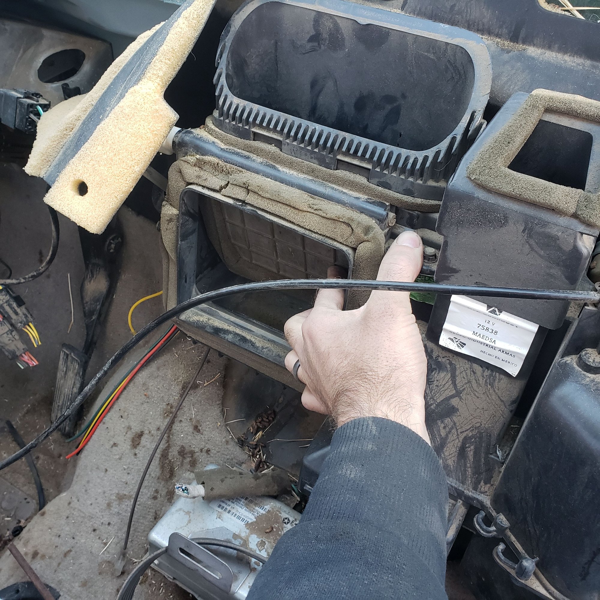

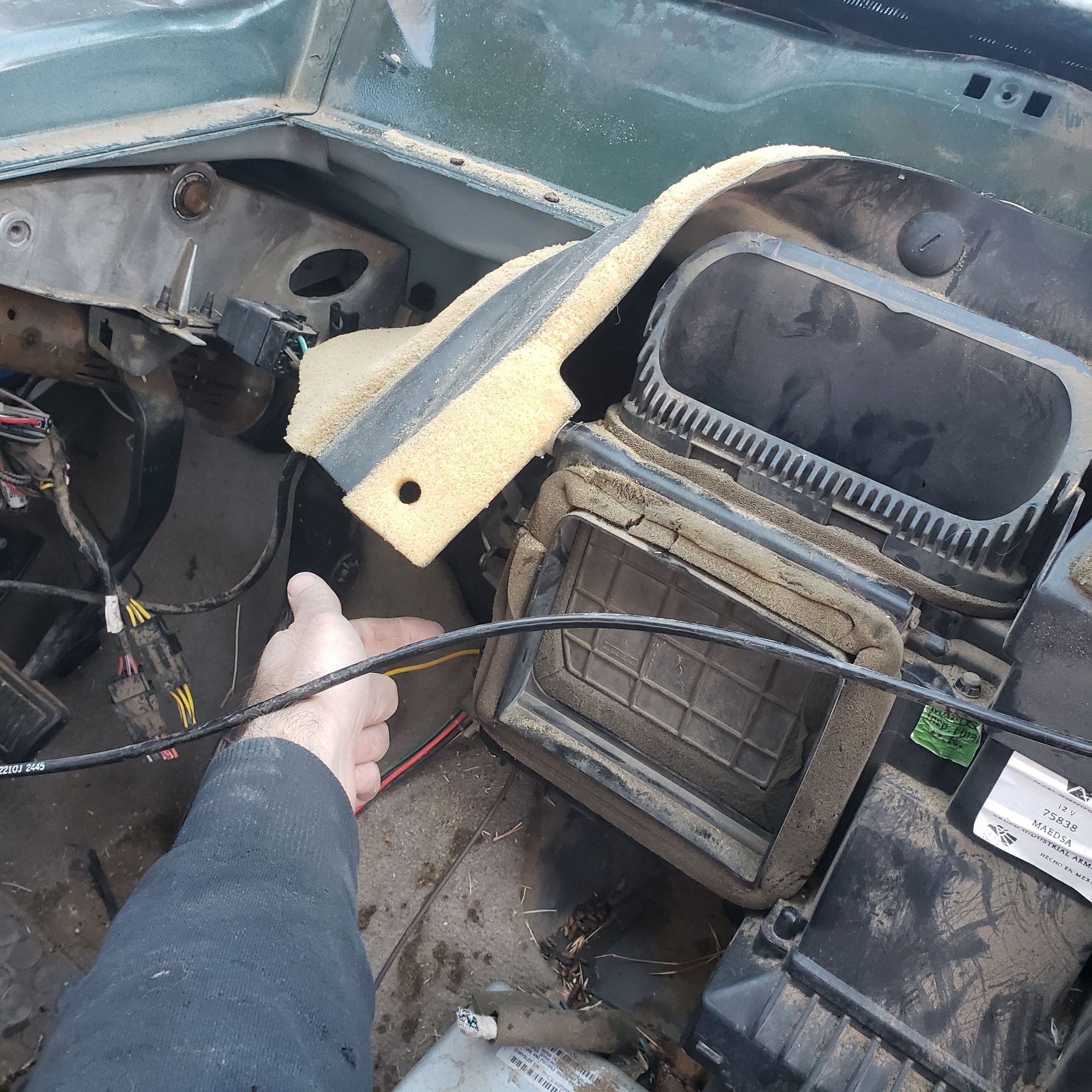

As viewed from driver floorboard looking toward passenger side, I drilled here. Round stock runs wild here (finger indicates)
I was fortunate enough to have a donor with dash already removed. Photo taken from passenger seat area, and finger indicates roughly where I chose to drill
This door dictates vent or defrost but it won't do anything if the "floor door" doesn’t first allow air to get this far. More importantly, you want to place your rod below the clamshell seam so it doesn't interfere with this door

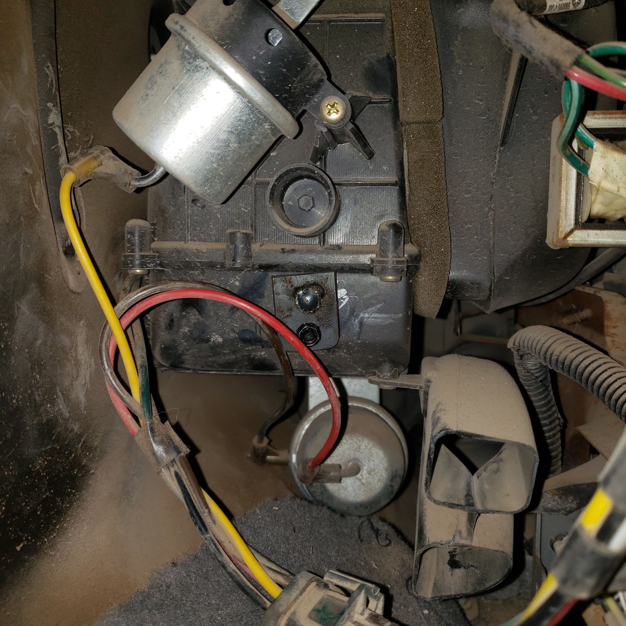

The problematic (in my case) "floor door" lives about here. You can actually see the upper hinge pivot above the green sticker. Since your dash will be installed, youll only be able to see the lower actuating arm tucked between the floor and center bottom of dash

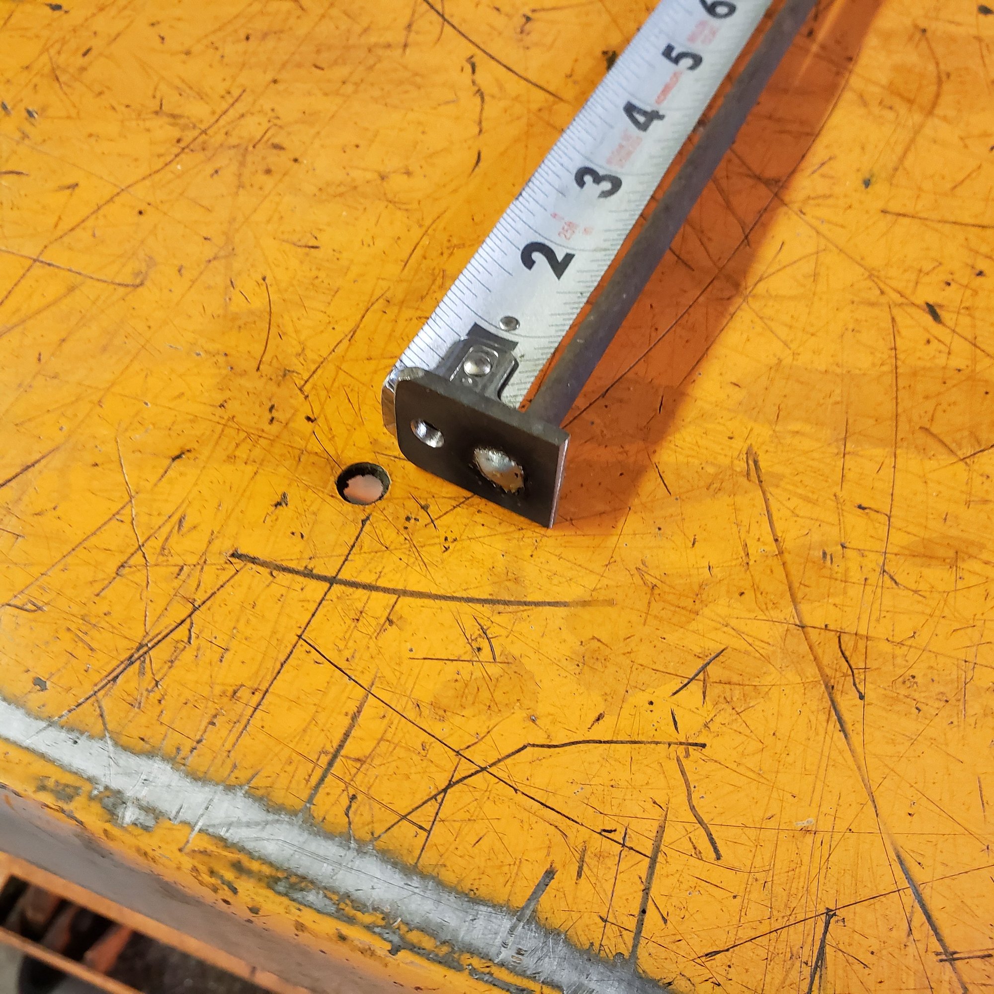

I wound up with a rod ~21.75" but honestly from later measuring my donor 16 to 18" oughtta do it. Mine is going so far it's front of my heater core, which isn't necessary. Anyway my choice of retaining tab shown here
Installed. Works great.
