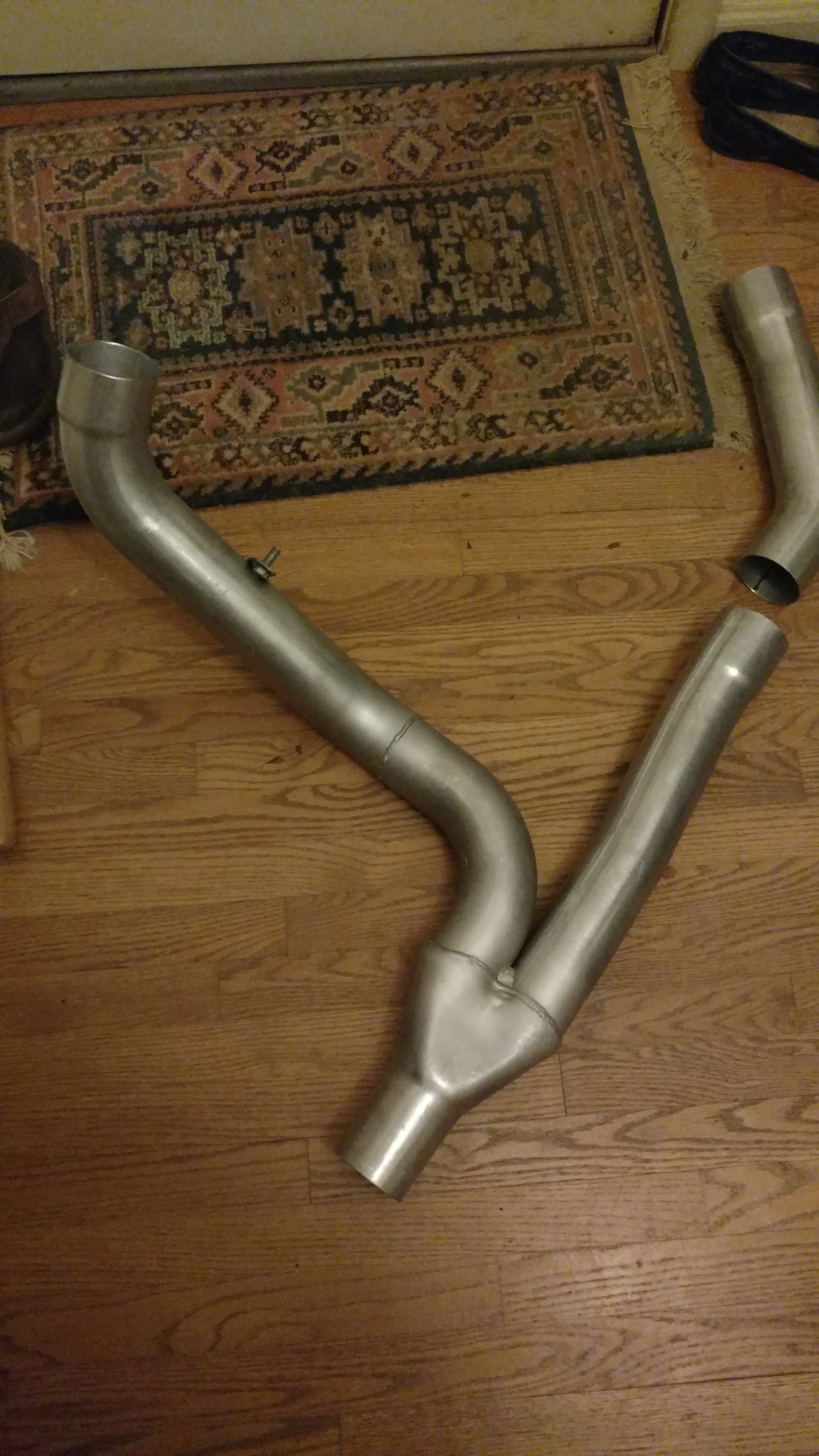

Has anyone bought one of the Pacesetter Y Pipes for a 2nd Gen Ram? I bought this one off of Amazon Warehouse and I'm wondering if they sent me the correct one. It doesn't look like any pictures that I've seen, but I can't find any that aren't generic stock pictures.

No, that doesn't look right. It should have flanges to bolt up to the exhaust manifolds.

I'm hoping to use their y-pipe with their long tubes and I know they just slip on. However, I'm thinking this is the wrong one since it doesn't match any of the pictures online.

Pics aren't always the actual product. Might wanna get the numbers off of it, give 'em a call, and see if it is correct.

That looks like the right one for the pacesetters. The short tube that is sitting loose goes where you have the longer tube to the left, then that longer tube goes between the frame and transfer case to the short piece. Hope that's clearer than mud

The pieces look about right for the Pacesetter Y-pipe, but the tag w/bolt I see in the pic is not there from factory.
The Y-pipe comes with clamps.
