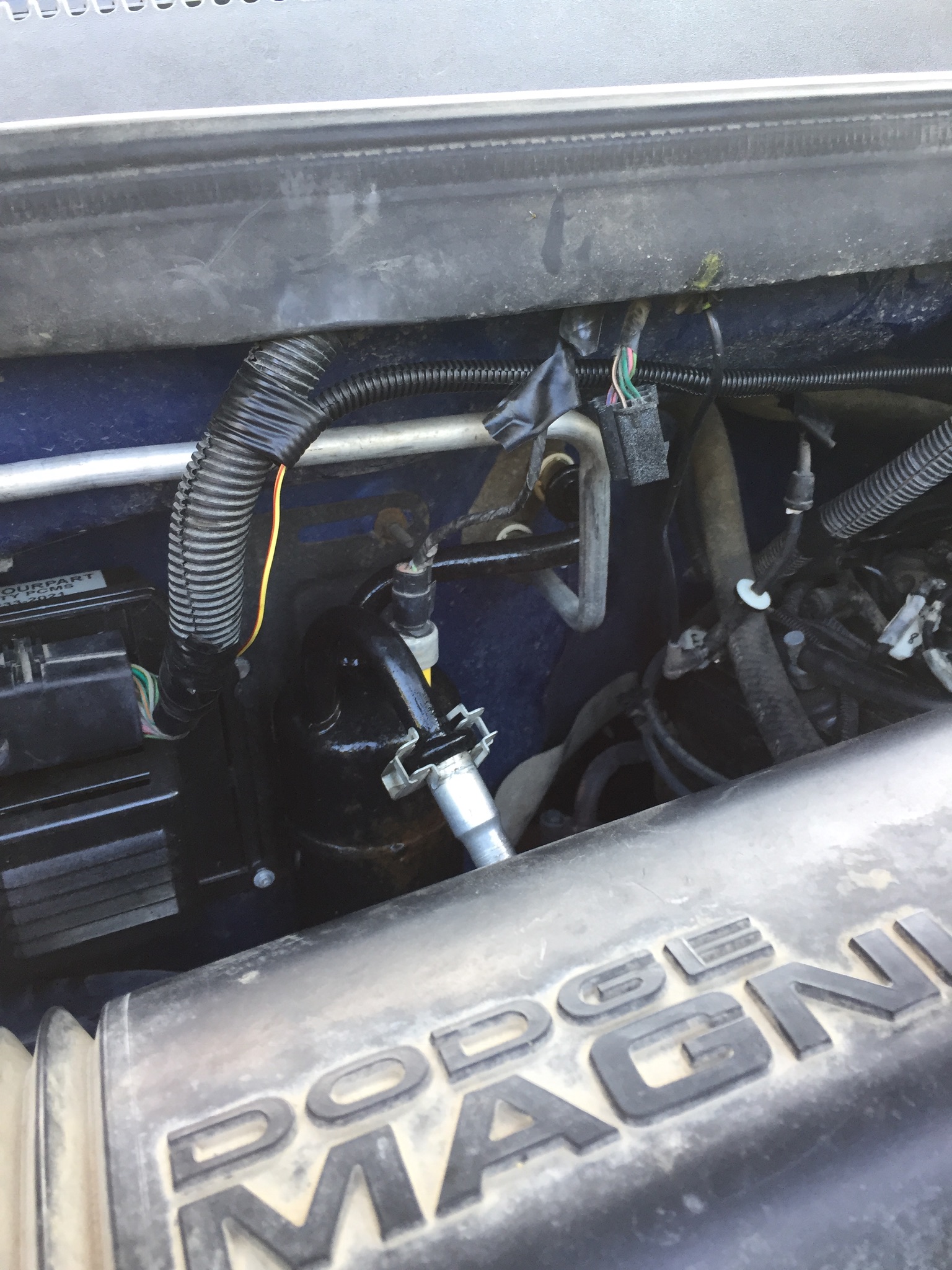

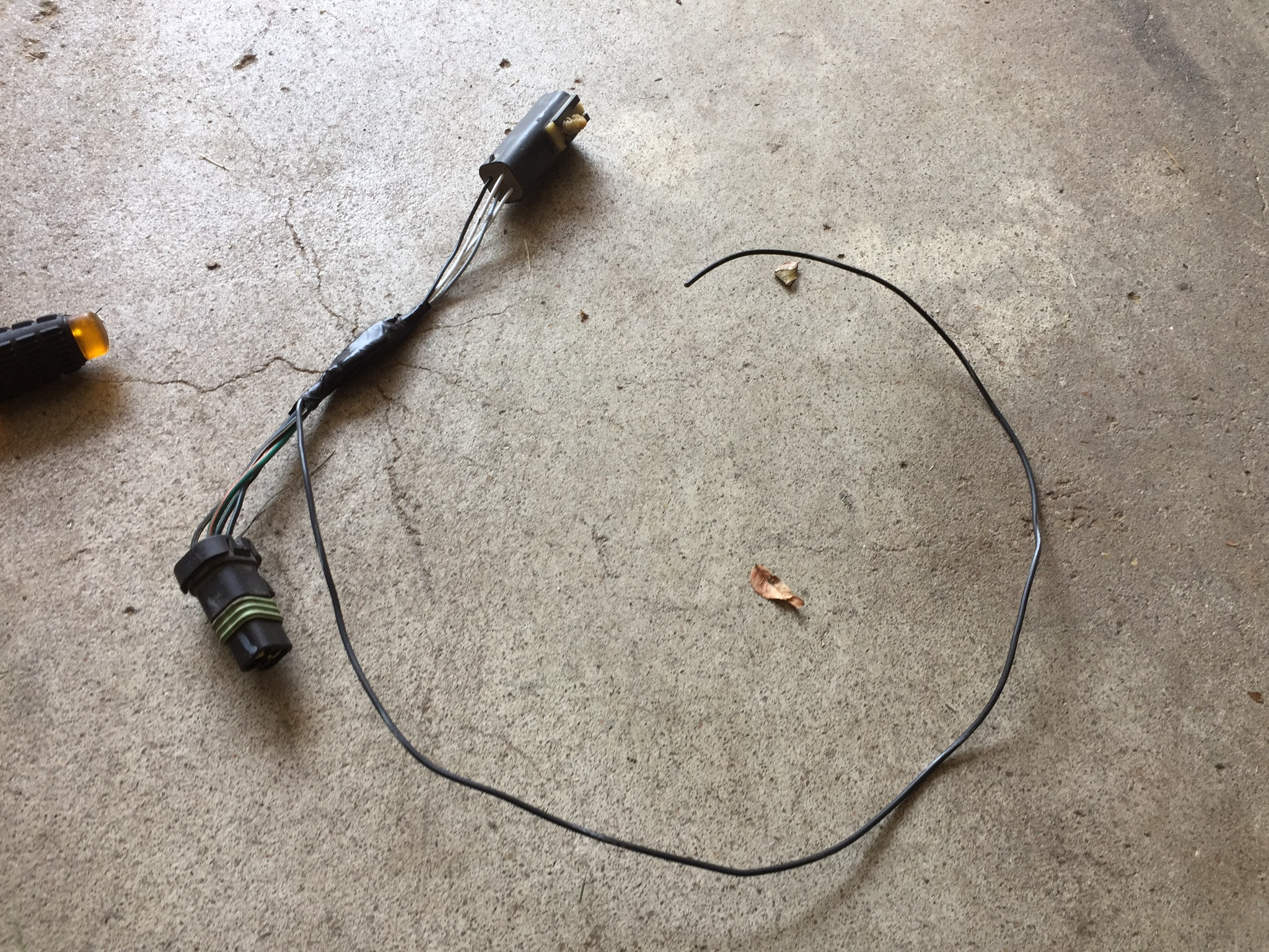

So today I got to the scrap yard to pull a wire and pin for the pcm connector, I also made my jumper harness so I could splice into the sensor signal. I installed the pin into cavity 23, plugged in the jumper, routed the single wire in conduit to the jumper, spliced them together and took it for a drive. After 10 minutes no more CEL and runs a lot better, especially at idle. Thanks for all who helped, especially hey you, otherwise I'd be more money into exhaust for a second o2. Fixed the issue for only $2.9 from the junk yard!
