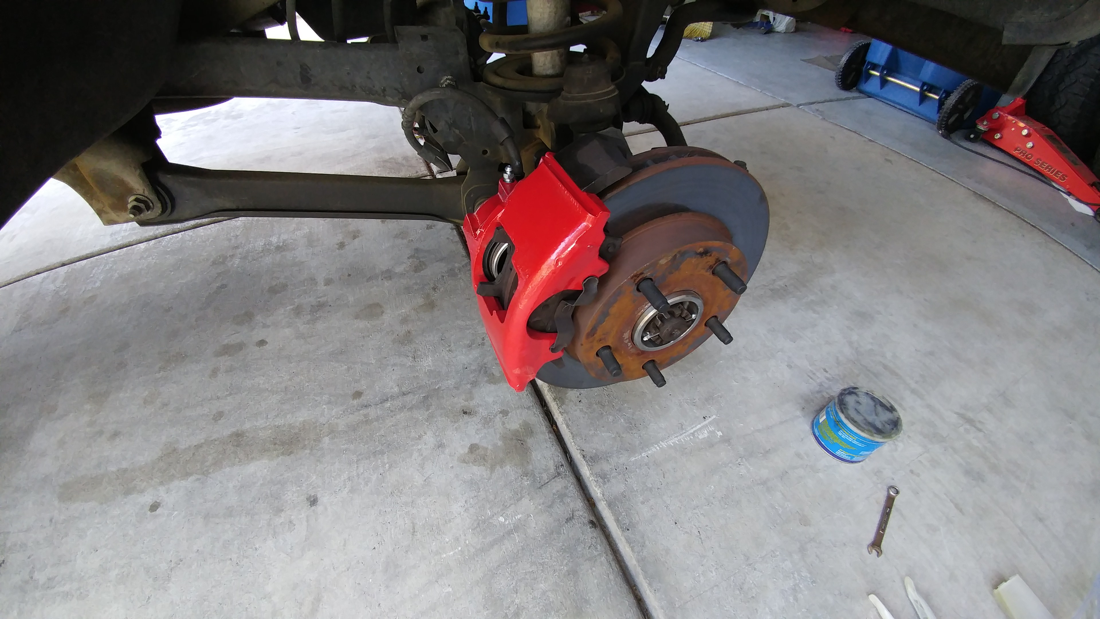

I got the bearing/hub replaced and put the new calipers on, reused old rotors and pads. I let them gravity bleed for about 30 min, and then bled each side with an assistant pushing the pedal. Fluid flowed well both times and is like new looking coming out. I believe I am getting a good bleed, the pedal firms up nicely, my daughter got a leg workout yesterday lol. I am able to say the power stop calipers are nice, come with new copper washers, they fit well and look nice, not that anyone will see them on my truck.
When the truck is not running the pedal is firm after only a few pumps and only moves a little(less than 3/4" I'd say) and stays that way. Then if the truck is started the pedal gets soft, going much further down, near the floor.
Just to recap, things done in order(not including inspections, or bleeding):
(by me:
Replaced master
Replaced rear shoes, drums, springs, wheel cylinders
(at shop:
Leaking( I think damaged on removal by me) rear driver side hard line replaced
Replaced master x2
Replaced booster
(by me:
Adjusted rears so they were not dragging
Adjusted brake light switch
Replaced front passenger bearing/hub assembly
Replaced calipers
I tried my vacuum bleeder, but couldn't get a good seal even with some grease around the bleeder, I will probably try to bleed it a little more with a helper before giving up(again), not sure what else to try honestly.
Any suggestions appreciated.
