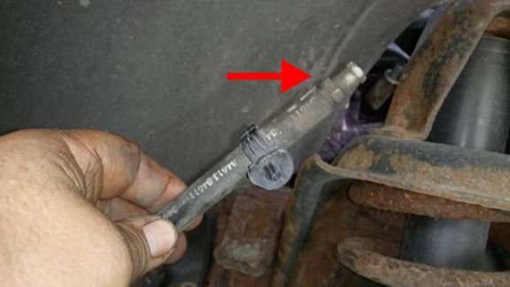

So I have this vac line that fell off the rear of the motor, I am calling it a vac line because it has a fitting to tie into another line somewhere I am doubting its a vent because of the fitting on the end .
this is the line end that came loose

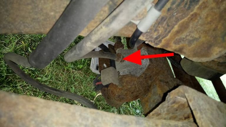

this is the line that comes out of the switch <br/>

Not a vacuum line, it's a vent line. It just clips up on the passenger fender well somewhere. Just secure it somewhere up as high as you can, but, not so high that it is going to rip stuff off when the axle droops.
