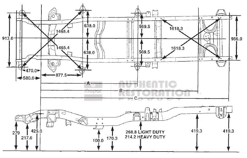

From what I've been able to find, there might be a 2" difference where the cab and bed meet.
94 to 97 frame specs... I think. A,B, and C specs pertain to cab/wheelbase styles.
I can't find any difference in 98 and later frames except cab/wheelbase configurations. I have seen a couple references to frame dimensions in the FSM (specifically 1999), but haven't been on my laptop to look for them.
This is an interesting research project now. Lol
