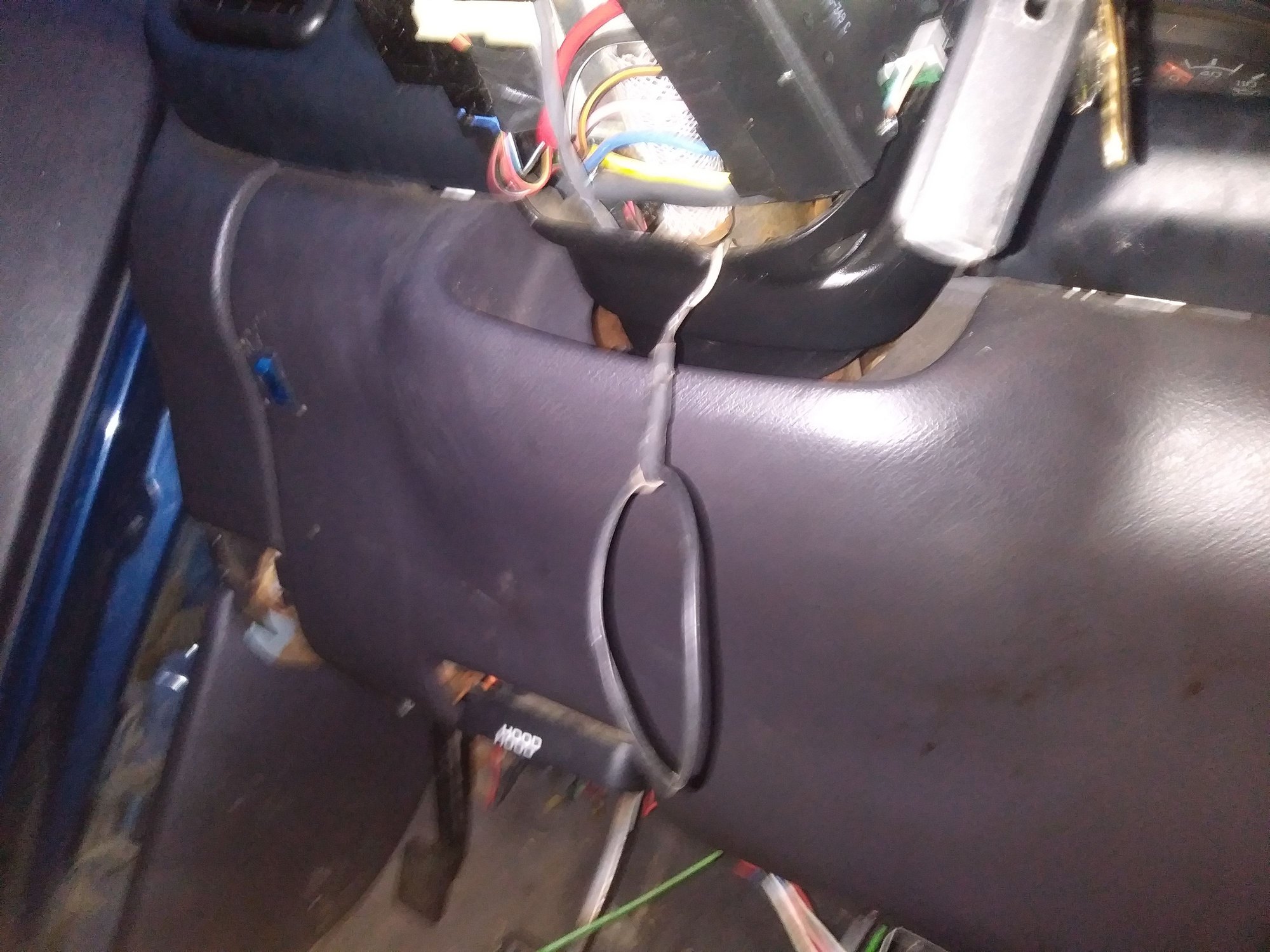

Also when I replaced the key system, I had a wore with a big loop in it under the cover of the steering lock. , so what is this and where does it go. Can't find,it on YouTube or Google. Or manuals,

Default Continuation no start
Hey you pin 30 and,85 made the light tester light up, pin 86 did not, also attaches is some,funky wire loop in my steering column . so,if pin 86 isnt lightening,up what could cause that issue, its a new relay, so I know,its working cause it makes a clicking,sound . When,i replaced the key system this poppes out, hehehe
