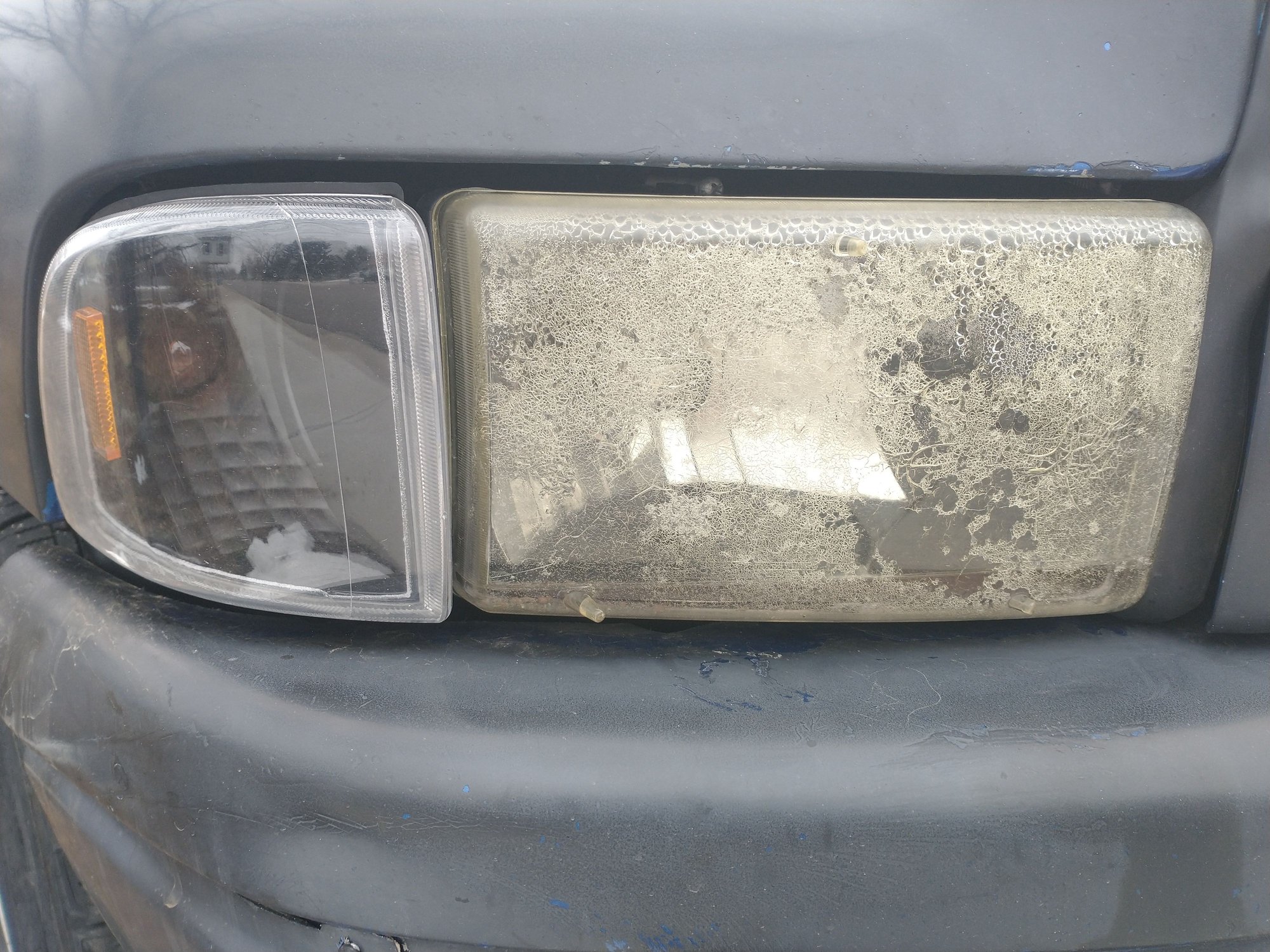

I had major issues/expenses last autumn (Western Colorado Saga) so, two years later, it is time again to finally address the headlamp issue as I had taken the truck out during daylight, parked for a few hours and found that it is currently unsafe to drive at night. I found one blown bulb, probably due to standing water inside headlamp.
When I search on Ebay, the adds state that they fit '94-'02. I desperately need headlamps but am very concerned that they will begin to crack again within 1-2 years. Maybe stock are of better quality?

P.S.S. My brother and I recently had a discussion as to why so many headlamps fade. My '99 Astro headlamps are still clear but the sidelights are yellow, which is the opposite of my Ram. He has the same issue on his Passat. Different types of plastic between the side lamps and headlamps? Why?

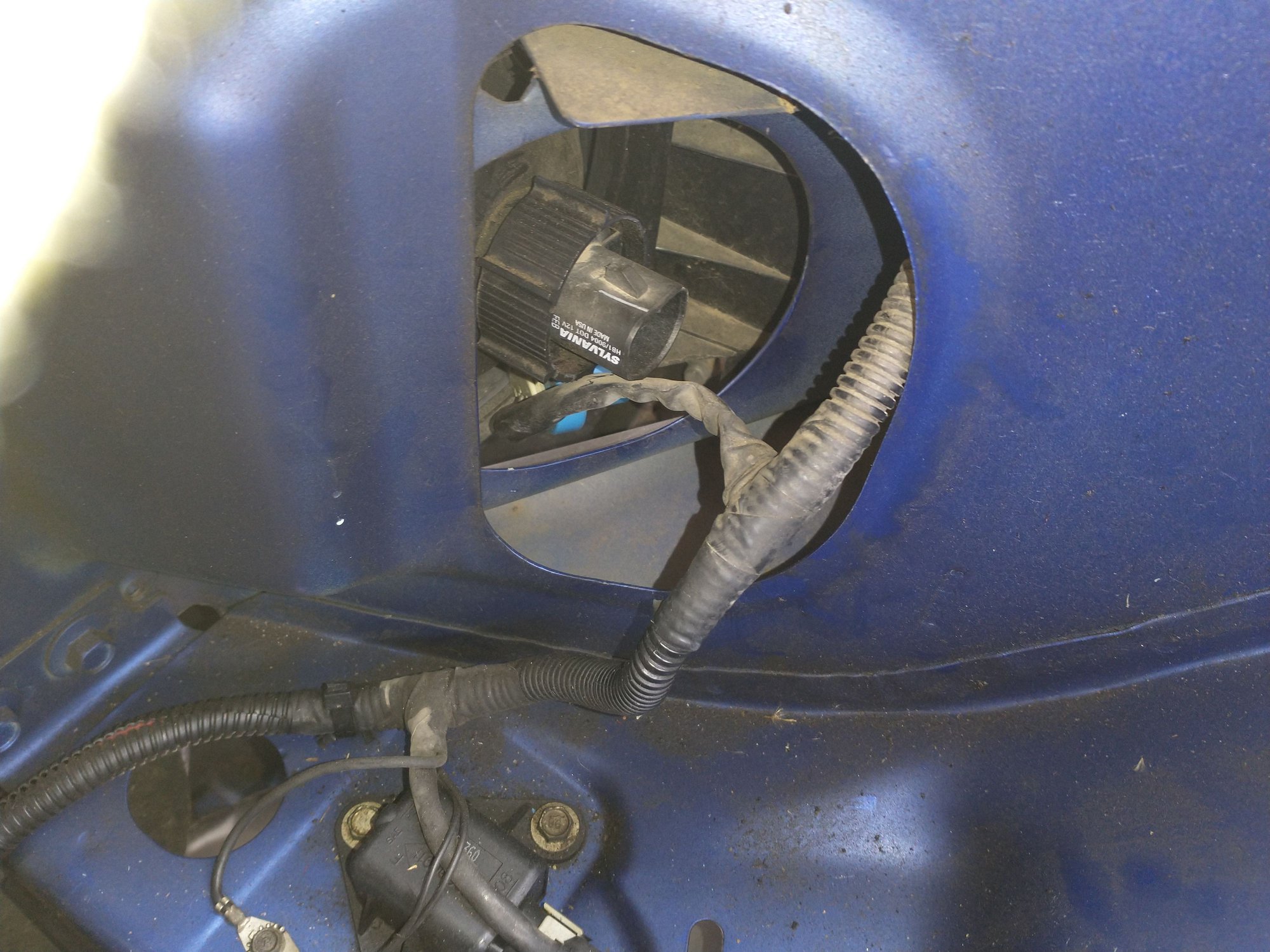

The sport headlights I purchased for my '96 truck were the 98.5 and up style sport headlights with 2 headlight bulbs per side. I wanted something to improve my light output and these fit the bill well, along with improvements from the relayed wiring harness I added. I did have to use a hacksaw on the fender light bucket to open it up to accommodate the deeper sport headlight housing. No cracks so far after replacement.

Shoveled a path to the truck and took this photo...
